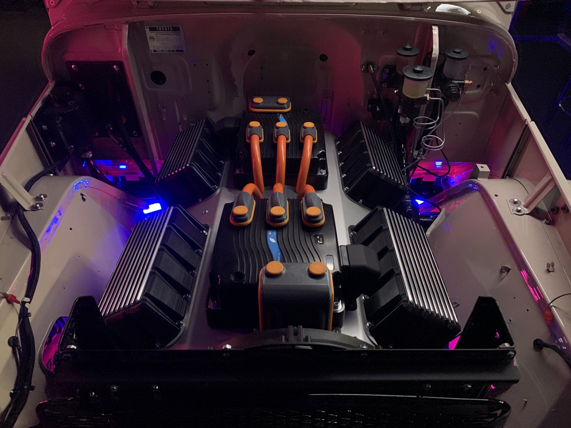

I was wasting time on the electricGT website today and although their plug-and-play systems are currently only available for the 40 and 60 series, it appears the 70 series could get some love too. Check out the vehicle fitment part under details:
Bumping this up, @Reinhardtius...
Did you get your EV conversion done yet?
Hey, I work with the guys at Electric GT and have been consulting on product development. I've driven the 40 series with the prototype motor in the pictures above and I'm working on packaging the kit for 60 series as we speak. I'm happy to answer any questions. The upcoming production system should drop right into 70 series trucks configured for a 3FE. We will have plug and play adapters to mate the system to gas H41/H42/H55 or even NV4500s with a GM input.
We will also be able to produce adapter systems to get you to a "build your own Hyper-9" set up, which would get your EV performance very much in line with the factory motors that older 70 series came with. The Hyper 9 systems are available now, we have CAD files for the adapters and brand new EV clutch systems, all we have to do is produce them (we aren't stocking a lot because Covid-19 has been really hard on us). I have a BJ74, and the Hyper9 will absolutely demolish the factory 13B-T even though the numbers are equivalent. It's pretty cool stuff.
I would have no issues putting one of these EV Systems in a Land Cruiser and daily driving it like a Tesla :) This stuff is bombproof. I can't wait to get this stuff online and see what people do with it.

Chances of seeing a 70 series specific system are really slim just because of demand. What you would need to do is basically retrofit the incoming FJ60/FJ62 system for the 70 series, which from what I gather really won't be all that challenging. Yes we are talking about Vehicle Systems.
If someone wants to commission a build for a full system specifically around the transmission input for diesels, it wouldn't take much to develop a diesel specific system. I believe the only real difference is input length and spline count of the transmission (someone please chime to verify). Until that happens we probably won't see a diesel specific set up on the R&D docket. The vast majority of the interest we get is from domestic Cruiser owners, with good reason. I love Toyota L6s but I won't drive one because of the fuel economy any more (which is why I drive my BJ74, 25mpg doesn't totally suck). We are getting some international interest, but we can't support them from afar right now. We would need someone local to work with. The good news is that you can just simply buy a new H55F from Toyota, so the added expense of converting to a gas configuration is a relative drop in the bucket.
Right now, a Build Your Own Hyper9 set up would be a slam dunk. It doesn't have the tire (and drivetrain) shredding power of the upcoming vehicle system, but it'll move you along just fine. All we would need is someone to work with us on getting adapters made. If you want to be a pioneer, your option would be to take the incoming FJ60/62 System and drop it into a 70 series. I'm sure there will be some surprises involved in the switch from LHD to RHD especially, but the drivetrain would pretty much drop right in as far as I can tell.
