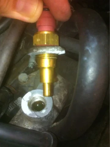

What's it doing? Just not starting when cold?
Is CEL on? If so, have you jumpered to check codes?
Check the tube between AFM and throttle body to make sure no cracks. Then check AFM to make sure it's good. My cold start issues were fixed by a AFM... along with some pump wiring issues. My fault on the wiring.
I've had good luck with a bottle or two of HEET in the tank if it's not driven regularly.
CEL comes on radomly but it seems to be only when the truck is hot, running down the interstate.
I'll check that tube, that was an issue on my 3FE. AFM too.
Issue is mainly cold start, but recently seems to have trouble starting when warm as well. Once it's running it's good to go. Seems to help when I pat the gas 3-4 times then hold it down to the floor.
Cold start injector didn't fix the cold start issue. Thoughts? TPS?
I doubt it's a TPS issue.
Does this truck have a FPR?
Call myron
Well that sucks.
Looks broke! JB weld that sucka back on with a bolt through the threads holding it down till it sets up so the threads still line up.
