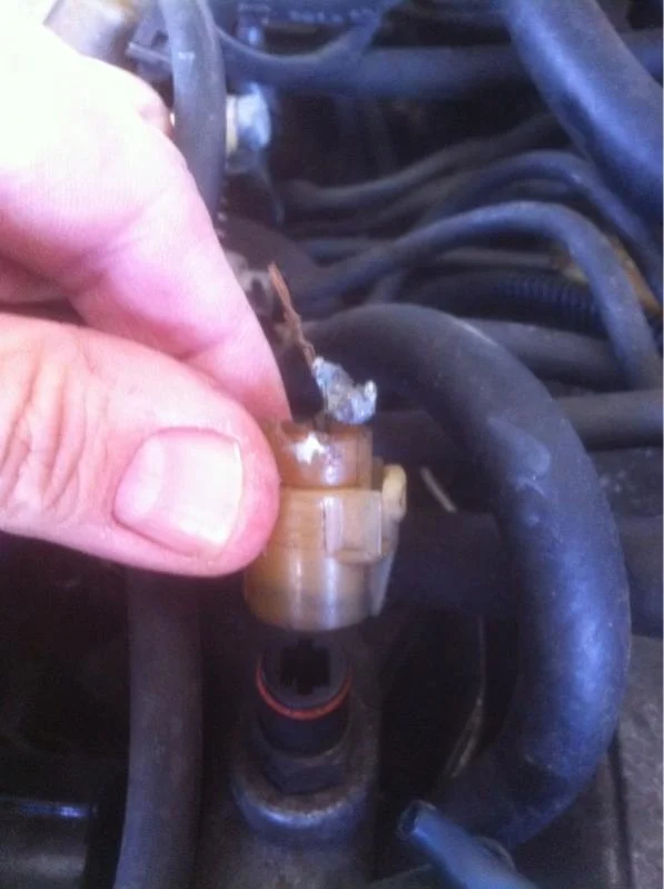

What is this? I thought it was the temp sending unit but unplugged, temp gauge still reading intermittently.
there are 2 temperature sending unit 1 goes to computer 1 goes to the gauge that is the 1 for the computer the cold start injector is also affected by that sending unit I believe . there is also a cold start timer on the very front of the intake manifold . ,you really need to check out roger browns website it is loaded with information . I would return the napa thermostat and by the correct toyota 1 that is listed on roger browns website

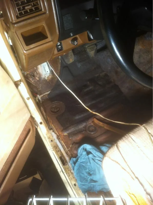

Thanks to PO for never asking the question "where is all the fluid going that is disappearing from the clutch master cyl?" I have a pretty significant rust issue in the DS floorboard. For now I've cleaned it up with brake cleaner and paint thinner then sprayed it with rustoleum. I'll come back to it later and do some rust bullitt treatment. Pic pre rustoleum.

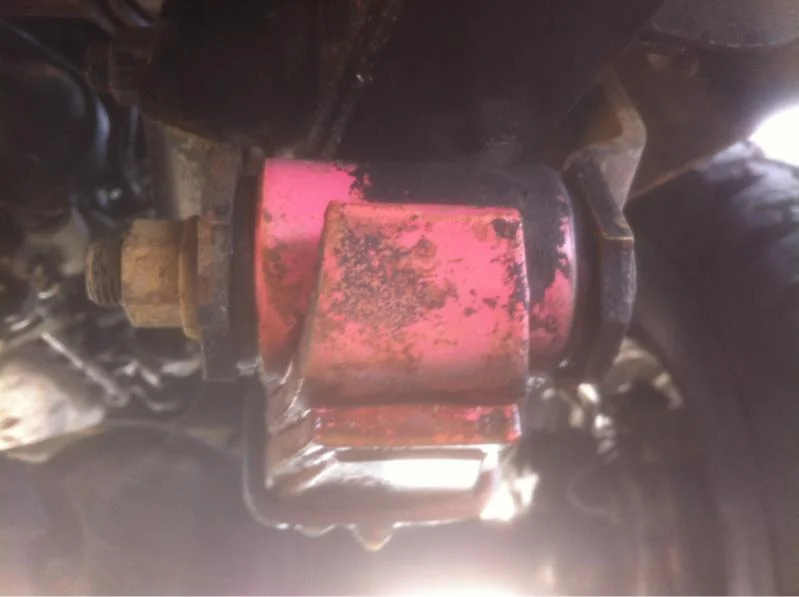

Yep, i believe the one on the right is the temp sensor and the one on the left is the cold start timer.
Ok, got it. Now why was I trying to find those?
