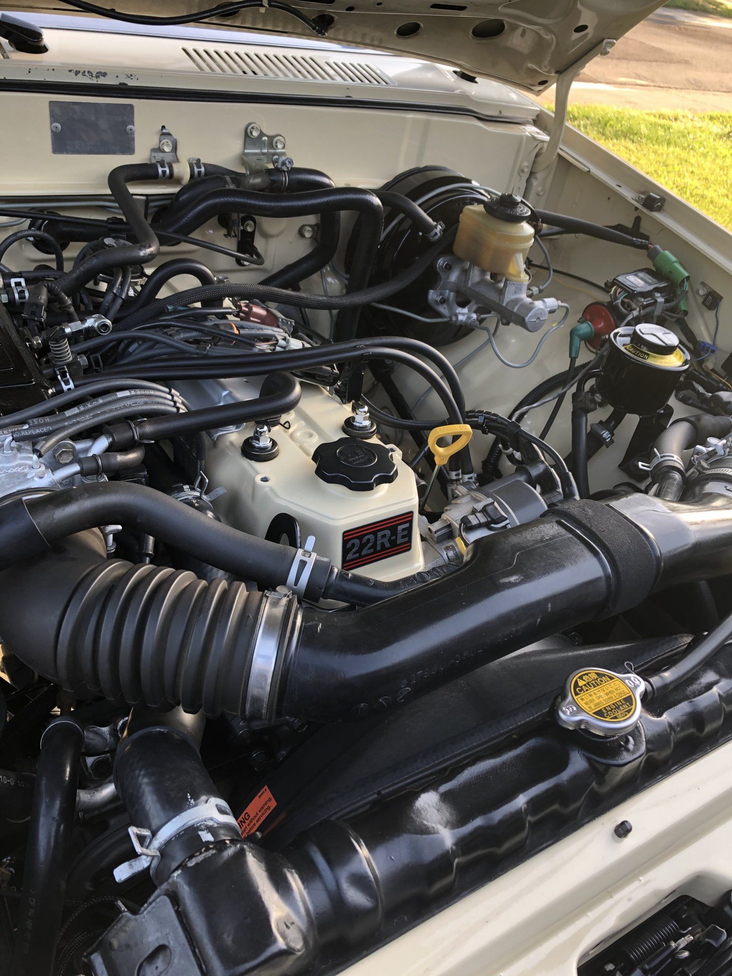

So, update on my head build... First off, gotta give credit where credit is due. The guys at Redline engine builders are awesome! Super helpful and nice along with great prices! Purchased his 281C Torker cam which he explained to me in detail was all around better than LCE’s Torque cam at $100 less. They make their cams in house and have been doing so for the last 25 years. Pretty bummed that I’m having to spend upwards of $800 to get this head done right but I guess it is what it is. Also gotta say that I’m not overly satisfied with LCE. I’ve been buying their stuff for the last decade and have recently come to the realization that they aren’t all that great... bought their street springs and retainers to put in my head and upon installation my machinist said that the springs were super sloppy with their “matching” retainers. I guess the retainer is supposed to fit nicely inside the spring with little to no play. These were all over the place. Not ever close. My machinist really didn’t like this at all. When I asked LCE about it they said it was fine. My machinist disagrees entirely. Performance 22re on the other hand, has a true matched set of springs and retainers. These guys put a lot of love and passion into their products and have things specifically designed for them. I’m not trying to trash talk anyone just giving some insight on my findings.

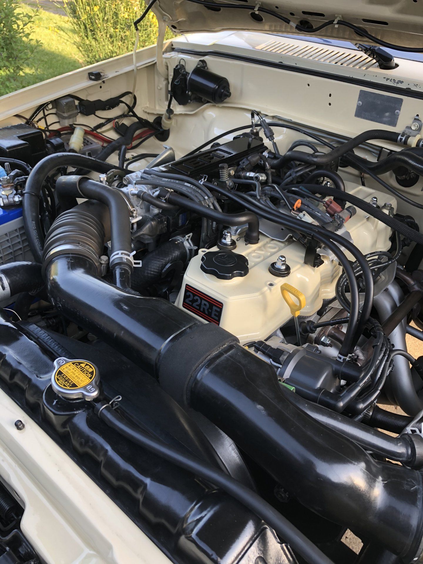

So, update on my head.... got it back and am pretty happy minus LCE’s horrible customer service. Final product is the original egn bldr head and valves with new seats, redline 281 cam, LCE springs, 22re performance retainers and keepers...aka frankenhead. I am to run zinc oil from now on as advised by both my machinist and the great guys from redline. Anyone else run zinc oil?? So Got it all installed and running Monday and am just working out some minor kinks. My machinist and the guy from redline cams worked together and selected the LCE springs for their pressure rates upon unloading. Nothing against 22re performance, in fact, I would rather have used all their products... all around better company. I guess LCE just buys products from other companies and just slaps their name on them. My machinist thinks they are super tech springs? Says they look identical and the pressure rates are the same. Great springs all in all but LCE’s “matching” retainers didn’t come close to fitting. They were super sloppy inside the spring. Don’t buy! Lol. The 22re performance ones actually fit them perfectly.
So anyways... after years of running down the rabbit hole of power lust for the infamously underpowered 22r and spending tons of money on various upgrades I was always left feeling unsatisfied. Upon reinstalling my accelerator cable I realized that my accelerator pedal wasn’t actually opening up my throttle body all the way!! Such an idiot. It’s like when a kid leans left and right with a controller in hopes to make them steer more in either direction, I would smash the crap out of my pedal in hopes of more power. After fixing it I damn near crapped myself with the outcome I got. My truck has never ran so good and been so peppy. Best power upgrade I could ask for!! Check your pedals!
