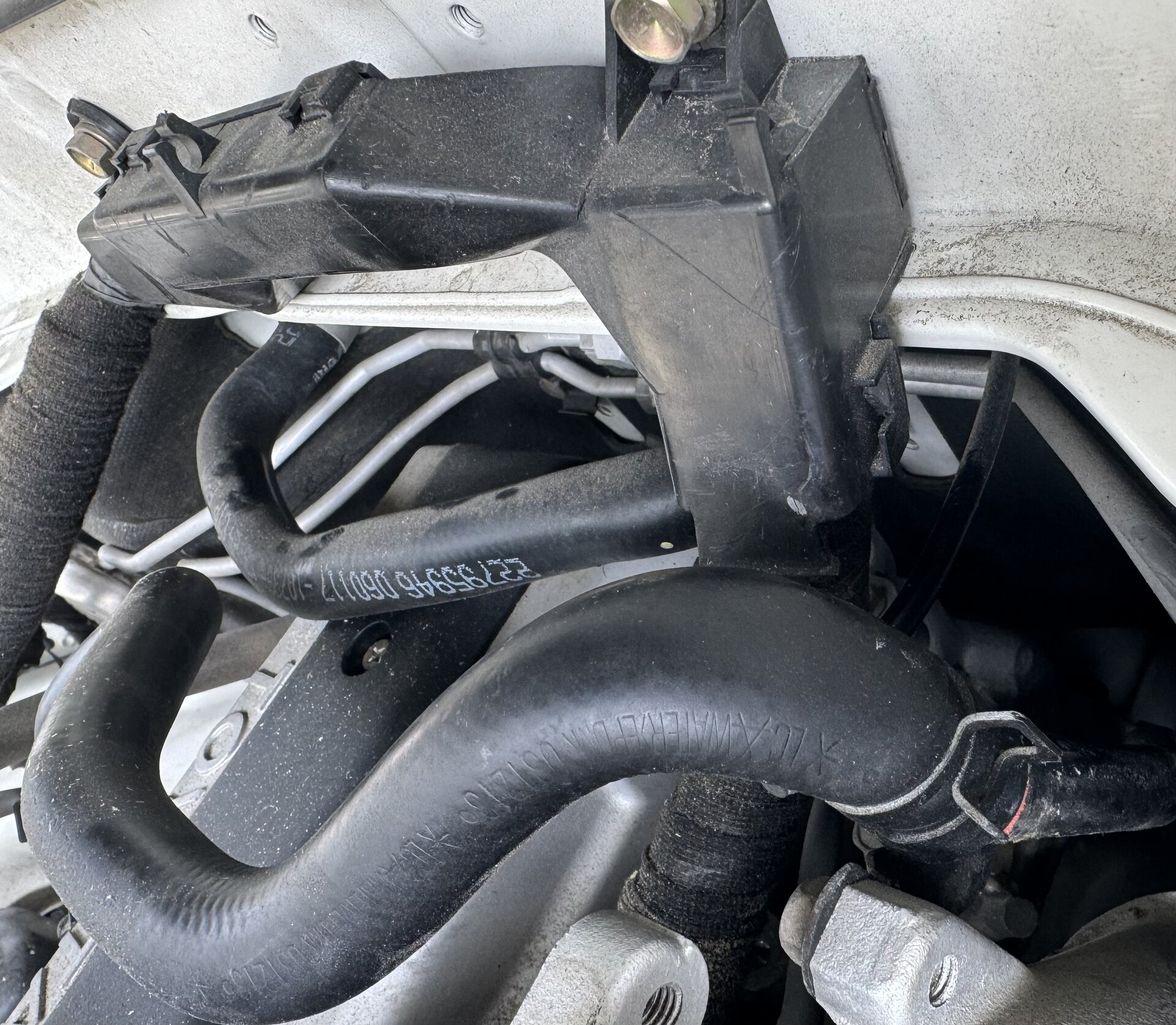

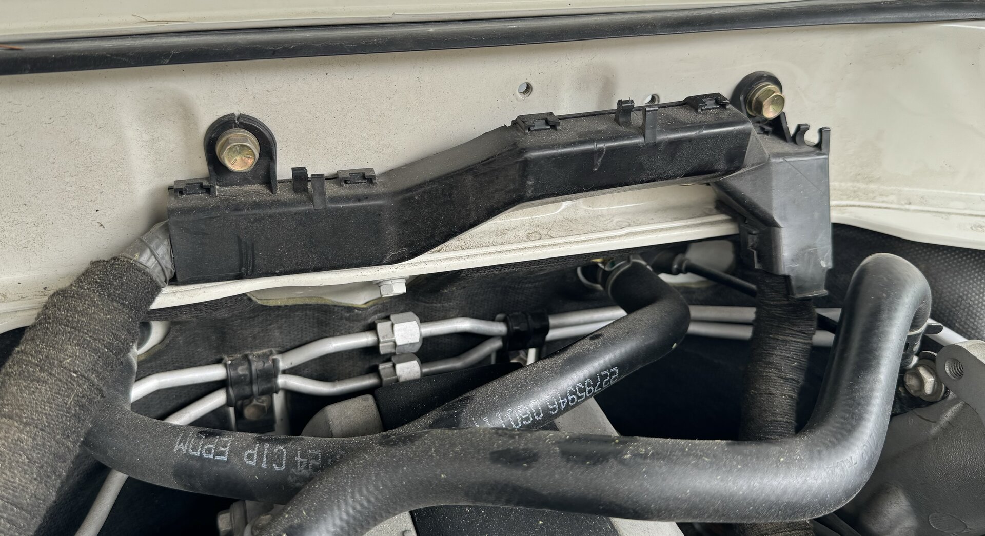

Here are pictures of the GCC Specs non-existent heater control valve.
IDK what you mean "non-existent heater control valve".
I do see front heat core is bypassed. Out hot coolant from engine loop back to return side engine.
It’s the GCC (Middle East) setup. There’s the option of adding the HCV.
