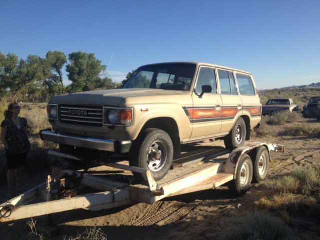

I'm currently in the process of resurrecting a 85 Fj60. It doesn't have a motor in it, motor got hot and cracked the heat. So I'm going to put in a SBC into it. Is it going to be a nightmare to get registered and smogged? I'm in washoe county and I've heard of people having problems and the rules have changed in the last year apparently. Any help would be much appreciated. Greg
A pic
