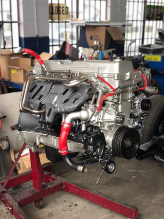

Hi Andy. I'm Eric, friend of Dom with the FJ40 in Carlsbad. My cruiser had a F that suffered the same fate as yours with a weak cylinder. Original plan was to rebuild but was concerned by the limited parts availability for the F engine. I ended up finding a good 2F, had it rebuilt and installed. I also recently installed a Holley Sniper EFI and I'm very happy with the performance improvements. Night and day difference from the stock F I had previously.
Thanks Eric. Who did you have do the rebuild?
I did the block and sent the head to Quality Auto Machine in San Diego.
The engine rebuild is pretty straight forward. Lots of good info on MUD.
Parts were sourced through various vendors on this sight as well as the local Toyota parts department.
