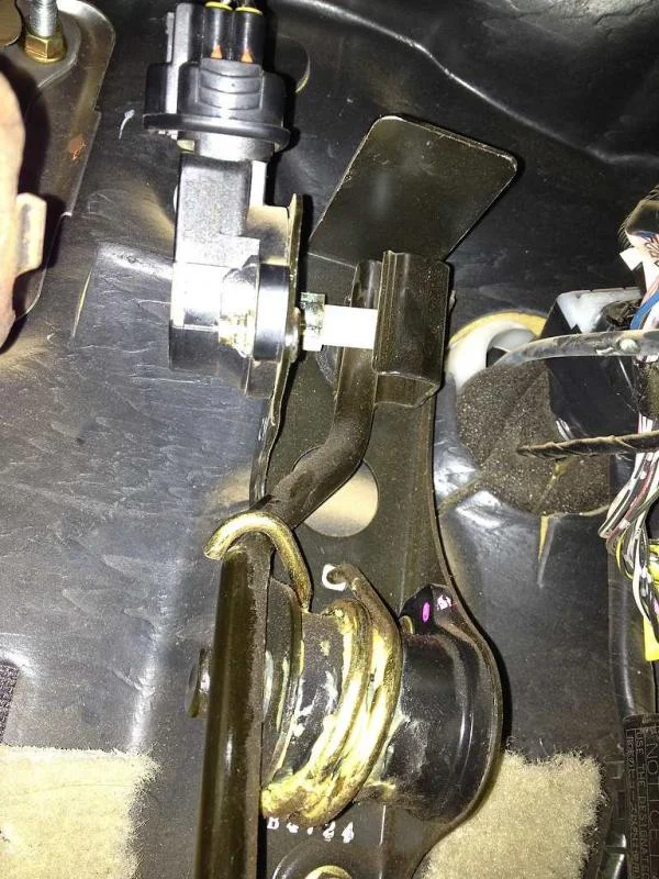

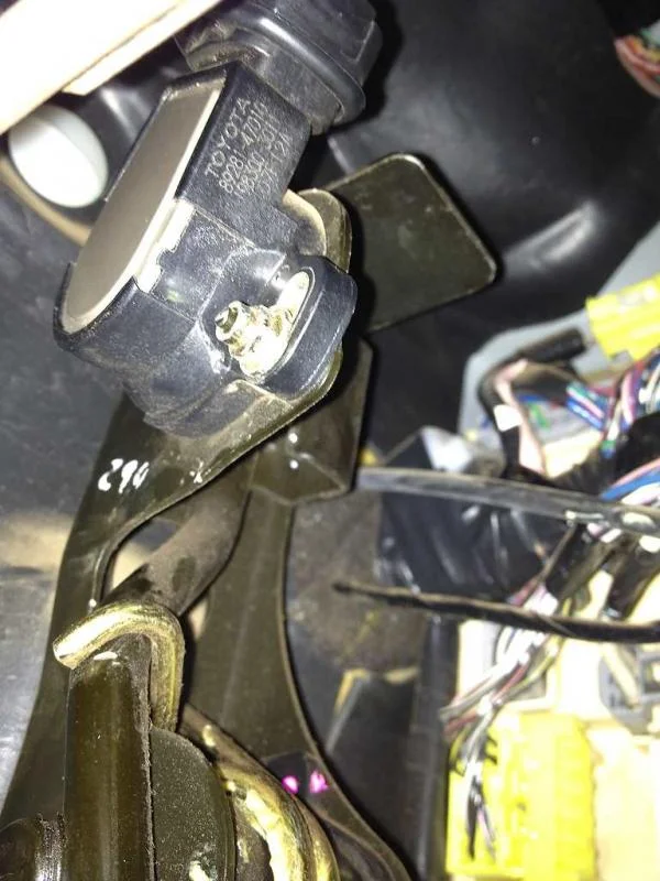

Insects aside (!!! I think they mean ants, which is possible), it seems the problem is related to the pedal position sensor. So I took it to my own mechanic to have a look and he also noticed that the pedal sensor didn't look right. We read the part number (89281-47010, 198300-3011, 07F12A) and it appears that some previous owner had replaced the unit with an incorrect one, I think this one is from a Toyota Corolla or something, probably due to lack of parts here in Kenya. Welcome to Africa....
I have read the whole TPS/APPS thread but I am still not clear on the difference between the TPS sensor and the APPS sensor, as most of that thread relates to '98/'99 models. Mine is a 2004 Japanese specification, GH-UZJ100W-GNAGK, Engine 2UZ-FE. in this model are the TPS & APPS sensors BOTH by the pedal? Or is one in the engine by the throttle? Which is the one by the pedal? And which is the one that error code P2121 relates to?
Toyota quoted me about $550 for "#78010 - Pedal Assy, Accelerator".
That said, they also quoted me $1100 for a new throttle assembly when their own mechanic said all it needed was cleaning - when I questioned it they admitted the error - so I'm not sure how much I trust them.
If anyone can help me identify what the exact problem is, and what are the correct replacement part numbers, I'd be most grateful. I'll be travelling to the UK soon, so could maybe pick up the correct part there.

On the US trucks, the TPS does not measure the pedal or linkage at all, it measures the actual position of the throttle butterfly. The APPS is the "accelerator pedal position sensor" it is located on the throttle body and the throttle cable connects directly to it. It creates and mechanical connection that allows the pedal cable to move the butterfly just a bit allowing for limp mode. In normal operation the APPS signal is used by the computer to position the throttle butterfly using the throttle butterfly motor (and the plate motion is verified/measured by the TPS).
What part number is your throttle body or could we have a picture of the throttle body?
Observing your photos it looks like yours is completely drive by wire without a throttle cable. Is that correct?
Correction, on older US trucks the APPS is on the throttle body. On the newer ones that have no cable and are completely wired the APPS is on the pedal. I BELIEVE this change was made in 2003 along with the rest of the major changes however it could have been sooner.
I think you have found the issue here - it seems that later models adopted a fully drive by wire (no cable) solution. I need to check the throttle area of my actual vehicle, but this is from a 2004 Landcruiser 100 series service manual I found on the net (can't tell which region though):
The Electric Throttle Control System (ETCS) is composed of a throttle motor that operates the throttle valve, a throttle position sensor that detects the opening angle of the throttle valve, an accelerator pedal position sensor that detects the accelerator pedal position, and the ECM that controls the ETCS system.
The ECM operates the throttle motor to position the throttle valve for proper response to driver inputs. The throttle position sensor, mounted on the throttle body, detects the opening angle of the throttle valve and provides this signal to the ECM so that the ECM can regulate the throttle motor.
The ECM determines the ”actual” throttle angle based on the throttle position sensor signal. The ”actual” throttle position is compared to the ”target” throttle position commanded by the ECM. If the difference of these two values exceeds a specified limit, the ECM interprets this as a fault in the ETCS (Electronic Throttle Control System). The ECM turns on the MIL and a DTC is set.
This electrical throttle system does not use a throttle cable.
This accelerator pedal position sensor is a non-contact type.
The accelerator pedal position sensor is mounted in the accelerator pedal to detect the angle of the accelera- tor pedal. This sensor is electronically controlled and uses Hall-effect elements. In the accelerator pedal position sensor, the voltage applied to terminals VPA and VPA2 of the ECM changes between 0 V and 5 V in proportion to the angle of the accelerator pedal. The VPA is a signal to indicate the actual accelerator pedal angle and is used for the engine control. VPA2 is used to detect malfunctions of the sensor itself.
The ECM judges the current angle of the accelerator pedal from these signals input from terminals VPA and VPA2, and the ECM controls the throttle motor based on these signals.

So I think this clears up the issues as far as my model is concerned and explains the confusion over sensor location.
Now my only problem is finding a replacement. It seems that someone fitted the APPS of a different model vehicle to my truck, and because the wiring connector was incompatible they cut it out and connected the wires directly, which is probably the cause of my limp mode problems. The problems haven't reoccurred (fingers crossed) but I'd like to get the proper sensor installed. I've found a secondhand pedal assembly, the problem is I can't find a replacement for the wiring connector part on the vehicle that it is supposed to plug into, which seems to have been removed.
Ahh yes, thanks for the clarification, I tend to get focused on my junk and forget the rest.
Glad the OP was able to differentiate between the two systems, pretty hard to identify which system we are talking about in the various threads.
OP, have you checked out the connector and wiring real well?
Hall type sensors are generally not failure prone but I could see it getting kicked or contaminated in that position.
