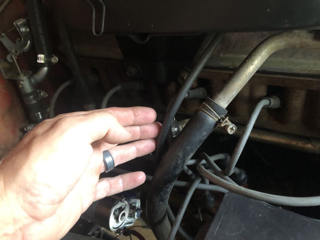

Here are a couple pictures of everything. I'll try to run with the choke in different positions tomorrow.
Engine history...this thing sat in a field for 20 years and I have changed all the things mentioned because it didn't run (had a couple stuck valves when I did the valve adjustment). I haven't messed with the points yet, but have a Pertronix system I can install (never checked the dwell...and honestly don't know how). Spark plugs, I will pull in the morning to take a look and will report. I'm not sure about the PCV connection, but I think that's toward the rear (passenger side) of the motor...should be in the pics). If so, that hose connects to the manifold below the carb. Since I have had this FJ40, I haven't had the motor running great for any consistent amount of time...it runs good, then does this kind of stuff. I assume it's because of the sitting in the field for 20 years.
This is the hose from the distributor to the base of the carb.

You need a new (best is OEM) PCV valve, that one is rusted and it isn't a Toyota OE valve. Your carburetor isn't original, so it isn't easy to control the power valve. Do you have a vacuum gauge, or a compression tester? Do you have a timing light? I don't know if you would be able to replace that EGR valve, but they don't age well, and you might just be fine with its removal and capping. As far as your exhaust manifold goes, it is for a later 2F, so I wonder if the engine itself was also swapped?

You need a new (best is OEM) PCV valve, that one is rusted and it isn't a Toyota OE valve. Ok, I'll order one. Not sure how to get that one off there.
Your carburetor isn't original, so it isn't easy to control the power valve. Do you have a vacuum gauge, or a compression tester? Do you have a timing light? Yes for vaccum guage and timing light. Vaccum (read from brake booster) is 19+ and timing is set to 7' (pretty much right on the bb). I don't know how or have a compression tester.
I don't know if you would be able to replace that EGR valve, but they don't age well, and you might just be fine with its removal and capping. As far as your exhaust manifold goes, it is for a later 2F, so I wonder if the engine itself was also swapped? I'm sure mine has been on there forever. I'll have to search on here on how to remove and cap that since I assume that was for smog? This engine is apparenlty out of a 1980...does that match the manifold?
