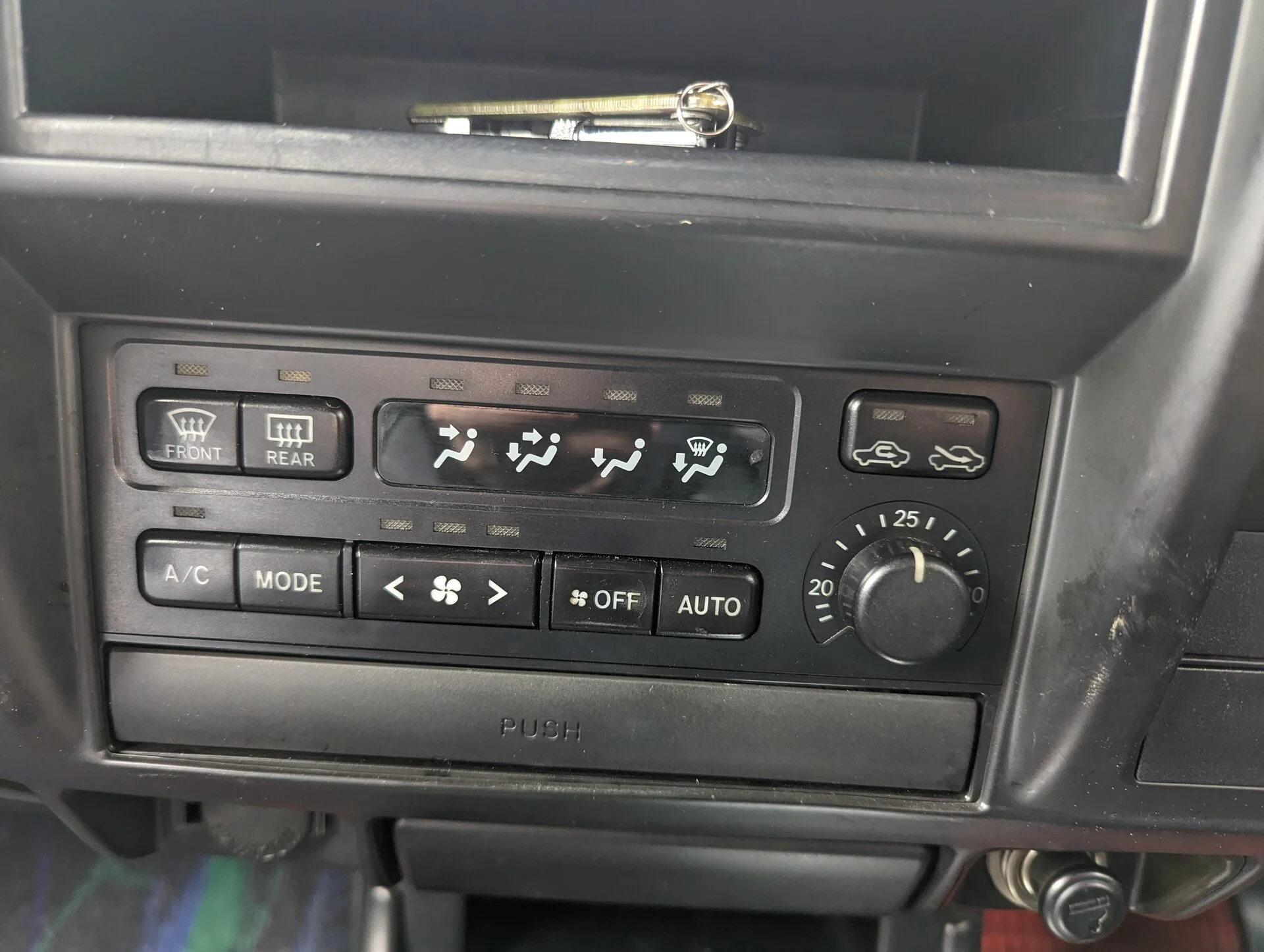

KB, thanks again for the detailed response. You are a great resource here! Hope to do my oil/filter, then the engine detail on Friday. One last question for now... I was out with the truck this morning and noticed some of my HVAC buttons (AC & MODE) had to be pressed firmly to respond. It seems that this is a common problem. Is there a fix or is it just wear & tear? Boy I wish I had a Owner's Manual!!

You're welcome mate. No idea with those buttons. If they're just a basic toggle on/off switch, I doubt they would just become faulty. Theirs a two wire plug that sits on top of the AC compressor unit in the engine bay that can become unplugged but still look like its plugged in. Maybe check that to see if it needs to be pushed back in. Maybe you have a dicky connection there? If you get really stuck, it's not too difficult to pull the center part of the dash apart and check the wiring/plugs behind those switches. Make sure they havent disconnected/part disconnected or wires become frayed or split/weakened. That's about all I can think of. Oh, check AC fuse as well. Reseat it and see if that helps. Replace it if its blades are corroded.
