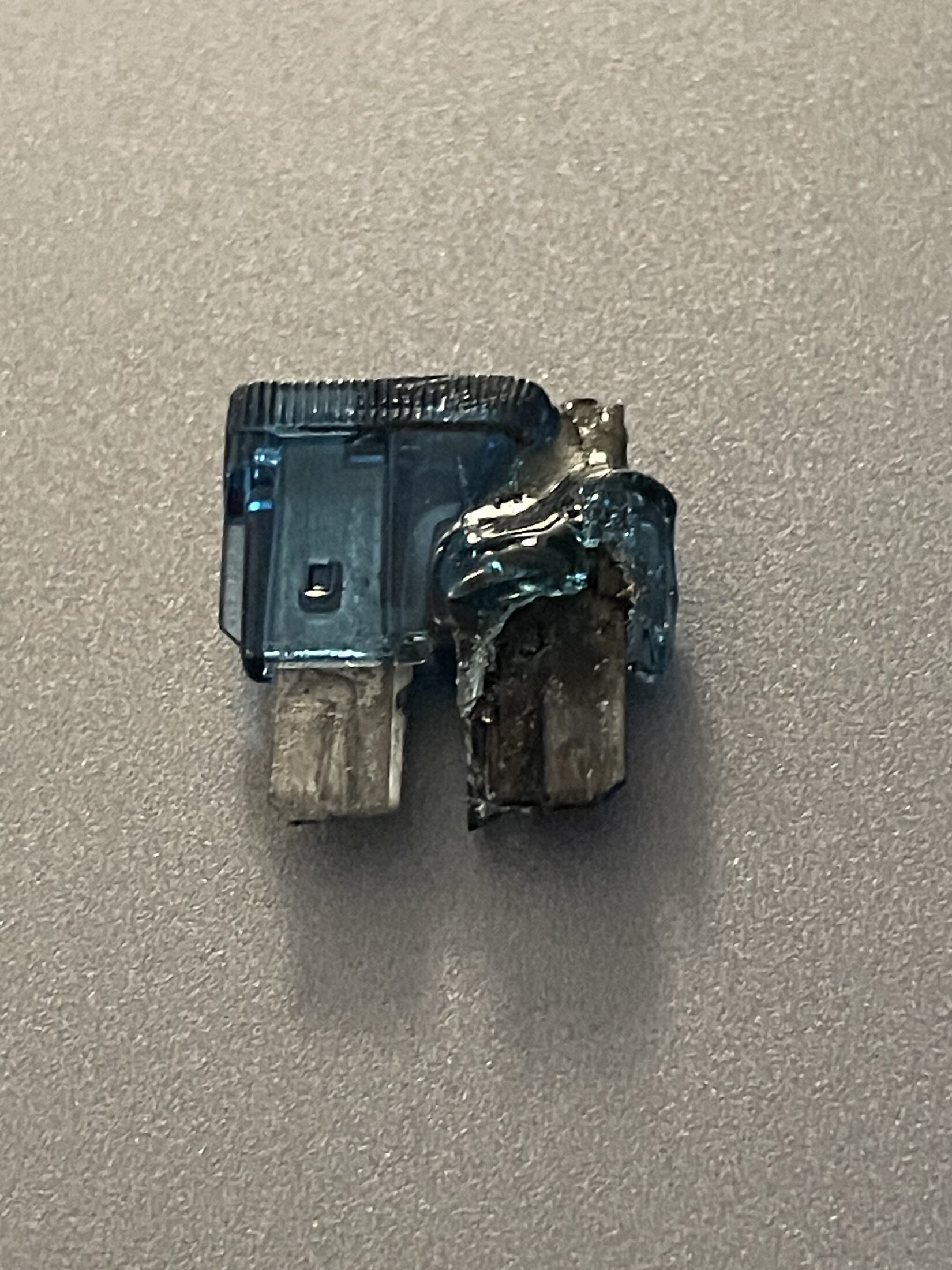

When I insert the key, the CEL blinks rapidly for 2-3 seconds and stays on. The engine will crank, but wont start. I was thinking about replacing the fusible link, but would like your thoughts and suggestions. Thanks in advance.
Found the issue…blown 15 amp EFI fuse. Replaced it and the truck is up and running. Now my friend’s Defender’s air suspension just died. Hope it’s just a fuse also…
And you're going to find out why it blew, right?
.....right?
Mmmm...that didn't blow it just melted down like lava hit it. I would definitely be checking things out before anything worse happens. Would also be checking the fuse block for damage.

Check the fuse box around that fuse. For the fuse to melt like that is not a normal failure.
That side terminal got hot before the little fuse strip blew out.
Maybe a dirty/corroded connection in the fuse box?
Check the wire underneath that fuse.
Something causing resistance or arcing at the connection, but somehow not overloading the fuse.

Well, we wasted so much time at the Land Rover dealership that all I had time to do was to clean the fuse box as much as I could (removed the melted plastic) put a small amount of dielectric grease and replaced the fuse. We then drove 220 uneventful miles and I’ll do a deeper dive in the morning.
Thanks again for the suggestions!
I suppose you read the fine print on the dielectric grease… best not to use grease on electrical contacts that’s designed to not conduct electricity. You certainly wouldn’t want to increase resistance between the fuse blade and the block.
Dielectric grease is one of those things that have dual personalities. Yes, it does not conduct electricity, but the fine print also says that it prevents shorts. Since I don’t know for sure what caused the short, I went with it.
@Tachycardic ,
The "grease" is a protective coating to reduce or eliminate corrosion but actually reduces conductivity which is no Bueno. That is a problem, it's not designed to prevent shorts. The proper use is to apply to more or less the exterior of a connector to stop/reduce/eliminate water and other contaminates from penetrating into the connector.
