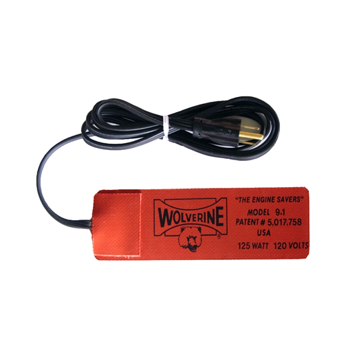

I cut the wires to my block heaters on both my engines in my Charter boat. I now use Wolverine oil pan pads, they work like a charm, a 250 watt pad will keep your oil toasty warm and all that latent heat will rise up throughout you engine. I highly recommend them !
