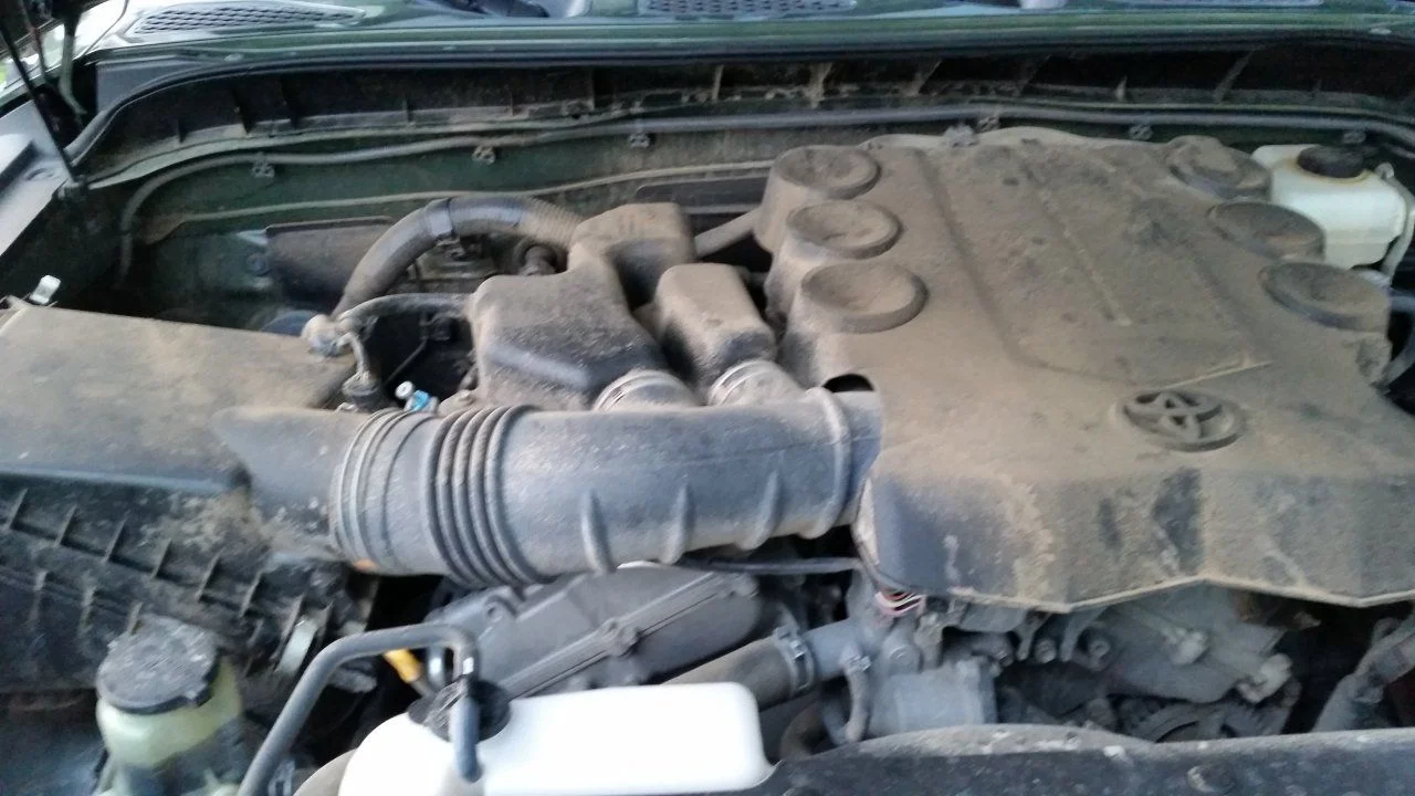

What is the best way to clean the engine bay on my '11? Can I power wash?
After recent trips to Big Bend and a 120 mile rt on the beach, it is messy. In particular, I was to get rid of the salt... Thanks!
