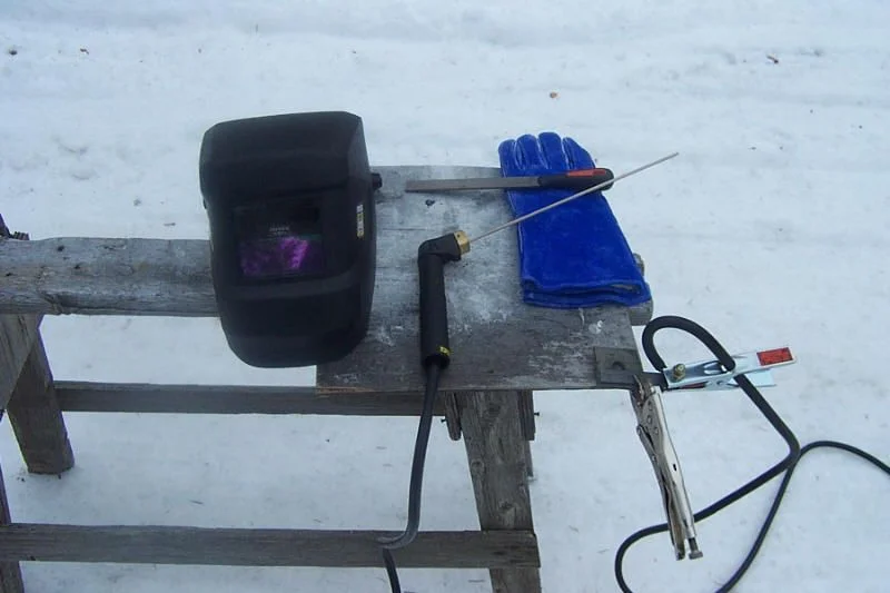

welded 1/4" to 1/8" (lincoln electrode E6011 3.2mm 1/8" "good call Pin_Head") no problem, beaded easy, need to practice more, you could weld anything on a cruiser using this method.
man, that was a lot of fun...:D
:beer:
Man thems some long cables! I wonder how much the voltage drop is across them?
good question, as it turns out not to much, as they are super heavy duty, off an old industrial "westinghouse" arc welder that i use.
edit - i'm sure there is some drop in voltage, but the welder can weld 1/2" using thems cables...
