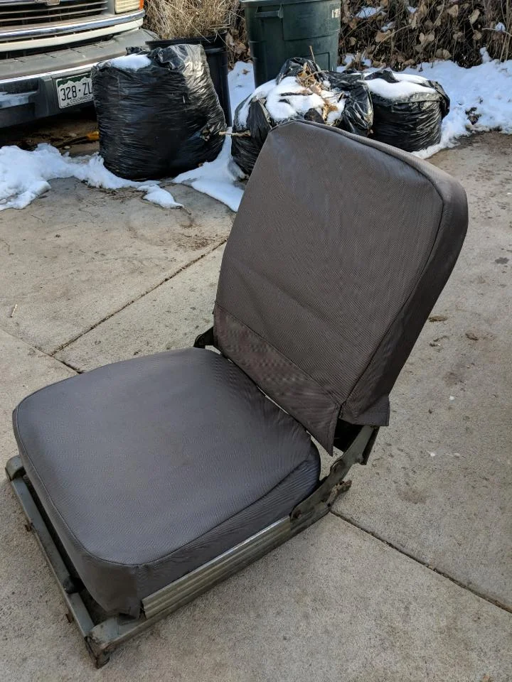

Since it's been down my wife took it upon herself to re upholster the seats!

Waiting for wifey to finish passenger seat now.......
