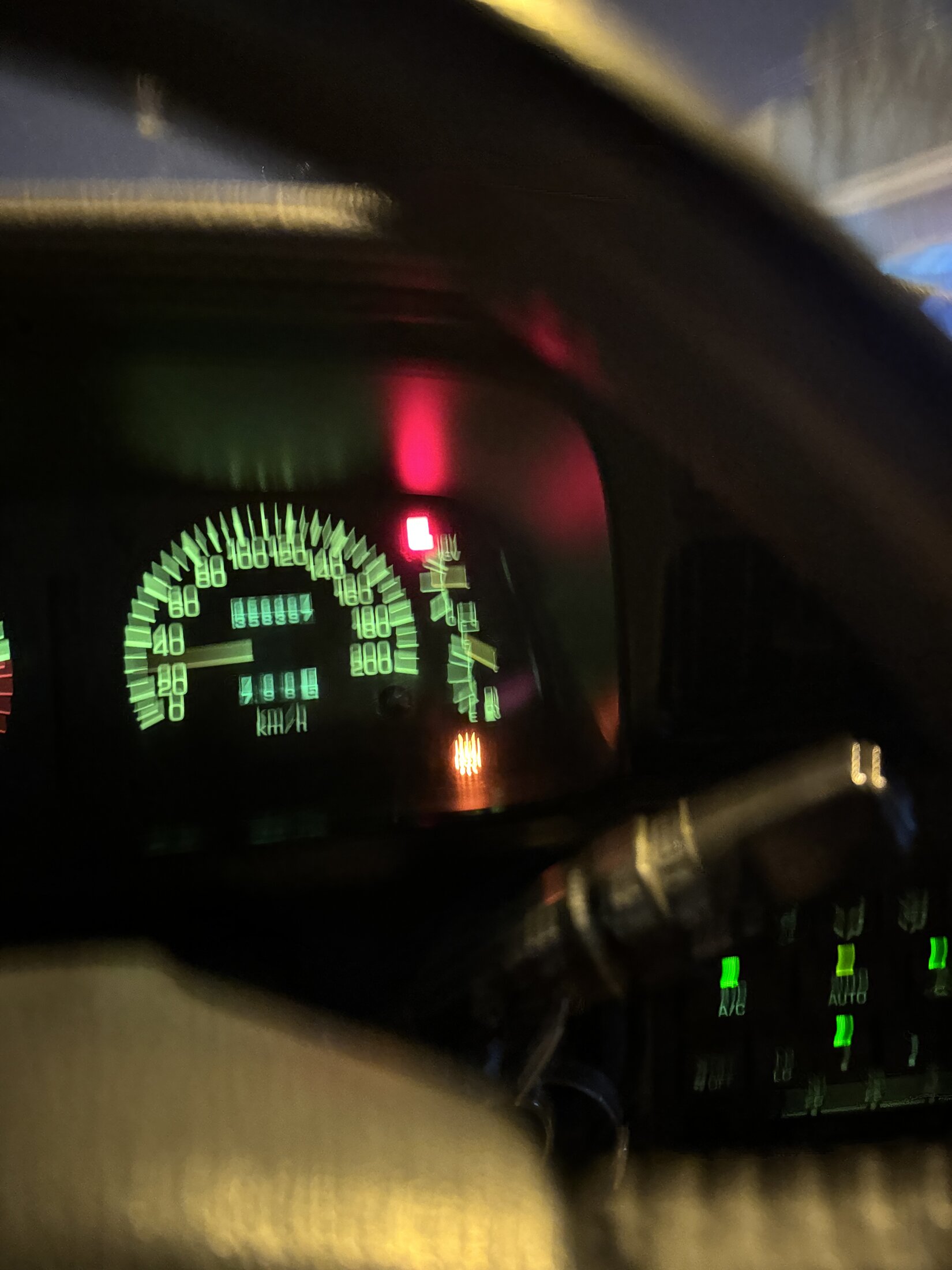

I just bought my new lc80 which is gcc spec so its fully loaded from diff locks to rear ac ,ice maker and adjustable suspension etc. the old owner had installed extra fans for the ac and 2 headlights which i didn't like so i removed them here where my problems began . Next day my battery was dead i took it to a garage he removed the lousy wiring of the headlights removed the extra fans (it was connected directly to the Ac ) he checked my alternator which was giving 12 v only so he fixed the alternator and now its giving 14.3 v and replaced some old urth and wiring, we noticed that the fuse box was played with, there was only one fuse for the oem head light which was burned by the way but the head light were working fine then i replaced the fuse with 2 new ones but now when ever i turn on the ac the battery discharge sign turn on and my oem head light on low beam the high beam bulb is lit bit dim . I really dont know what to fix
Fixed ! I removed the ac fan i think there was a short
