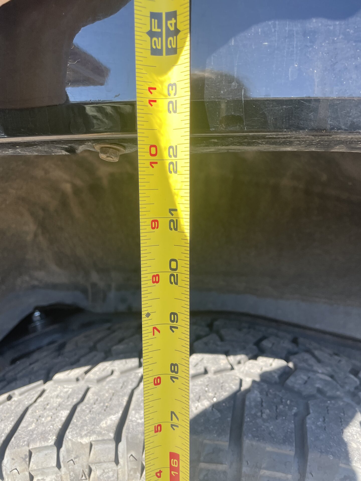

I am even 21.5" from rim center to fender on the front.
I have a gap of 23" on passenger side, fenders to rim c
Gap of 22" on drivers side.

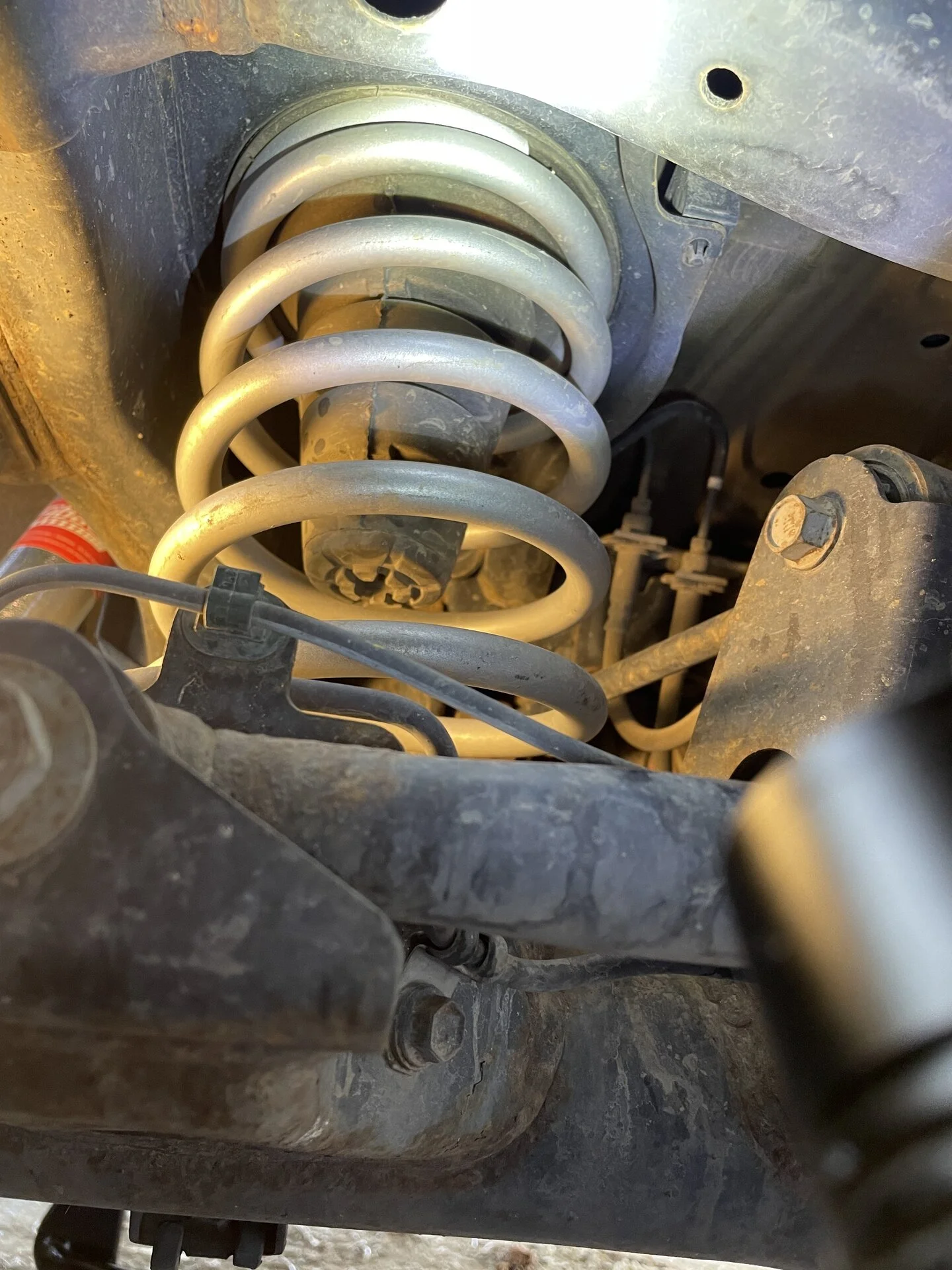

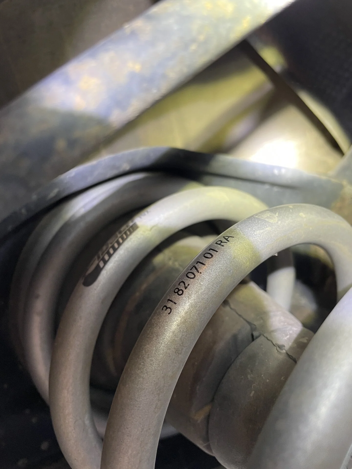

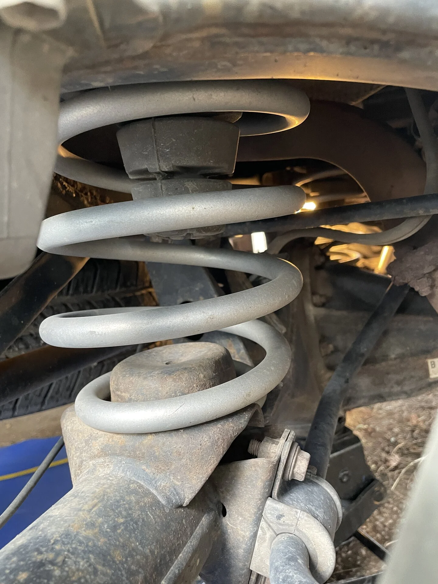

Springs are same parts #, and install looks good incl bushings.
I'm getting ready to overnight a new set at my cost (eibach is studying the problem... still. Been talking to them.)
Had a shop confirm with a quick look that install looks good and no other obvious issue.

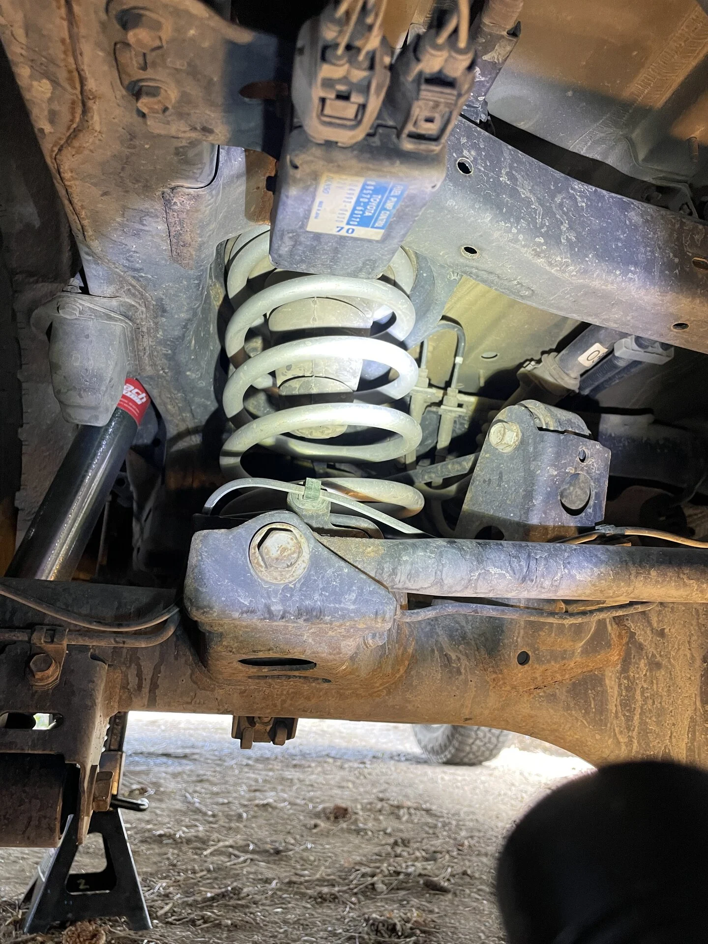

More pics.
Get a little variety to the measurements in rear depending on how many times i lift and resettle the truck, but is always off from half to full inch.

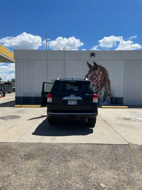

5 more pics

You're running Eibach shocks from a Tundra on the rear? I'm curious how that's working for you, I know the ones that are made specifically for the 4Runner are too short. I might suggest removing the rear springs and comparing them side by side. Maybe swap them from side to side. 4Runners are known to lean left. I have spacers under my left front and left rear OME springs that keep me level.

OME has intentionally made springs longer for the drivers side of the 80 series Land Cruiser in Australia. So when springs are installed on LHD the springs that are designed for the Australia RHD need to be installed on the left side.
But that might not be the case for a vehicle that was not available in Australia.
1/2” difference is not anything I’d worry I’d worry about. 1” or more and I’d look at things. If Eibach says they don’t have a left/right specific coil, I’d shim it like others have above, and get on with life.
