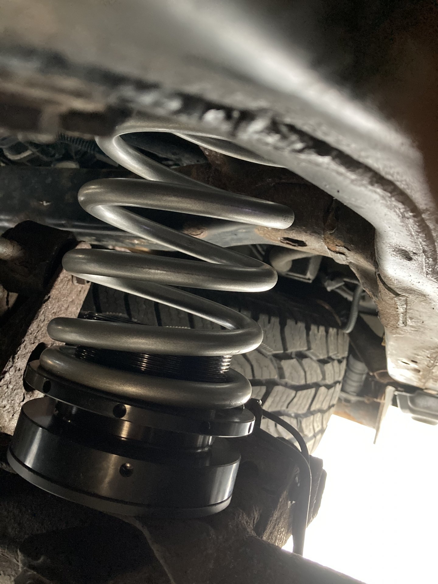

I just ordered a mid-travel Fox Factory Race Series 2.5 front and rear from Accutune and I'm looking a rear coil kit option. I'll be towing (~250lb. tongue weight), so this looks like a great option in addition to the adjusters on the Fox shocks. With this system, I can adjust for the added weight, and also have adjustable height on all four corners, which seems like a big bonus as I may add a rear swing-out at some point. I'm leaning toward the +250 lbs. additional weight option because of towing and gear when traveling, but not sure. Not a ton of extra weight in back besides trailer, maybe 100 lbs., and in DD situations, there will be nothing in back. I'm guessing that the 250+ kit will help it get up a bit higher than the No Additional Weight kit. Any thoughts?
I was thinking of adding airbags for leveling when towing, but with the adjusters on the Fox, I may be able to skip the bags. The Eibach kit would replace any need for bags at all, though it's a bit more of a hassle to adjust for load with these than airbags. But these would give me more options for adding weight in the future without having to change out springs...
This is also a bit spendy, but cheaper than having to swap out springs later on when my configuration changes.
One thing I just can't figure is the call-outs for height adjustment for the 250+ kit say "For +0.5 to 2.0 in." of Lift with 250LBS of Added Weight" in one spot on the product page, and then it says "+1.8-3.2 in." for Rear height lower on the page. The options page (screenshot) says 1.8 - 3.2". Anyone in the know as to why the differences?
I wonder where it would sit with no load? I plan on 2.5" in the front and would like the rear to match. Do you think I could get away with the 250+ kit on the back, set all the way down, and keep it at ~2.5"?
