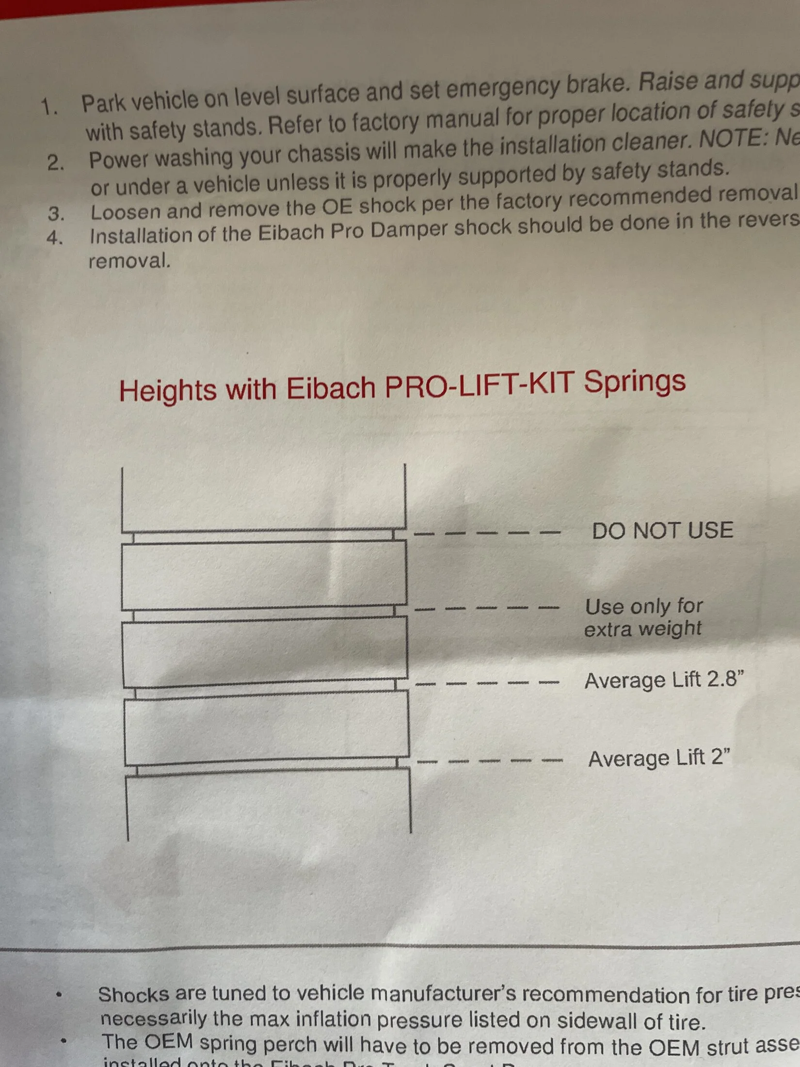

To have the truck level front/back what setting should I use on the front struts?

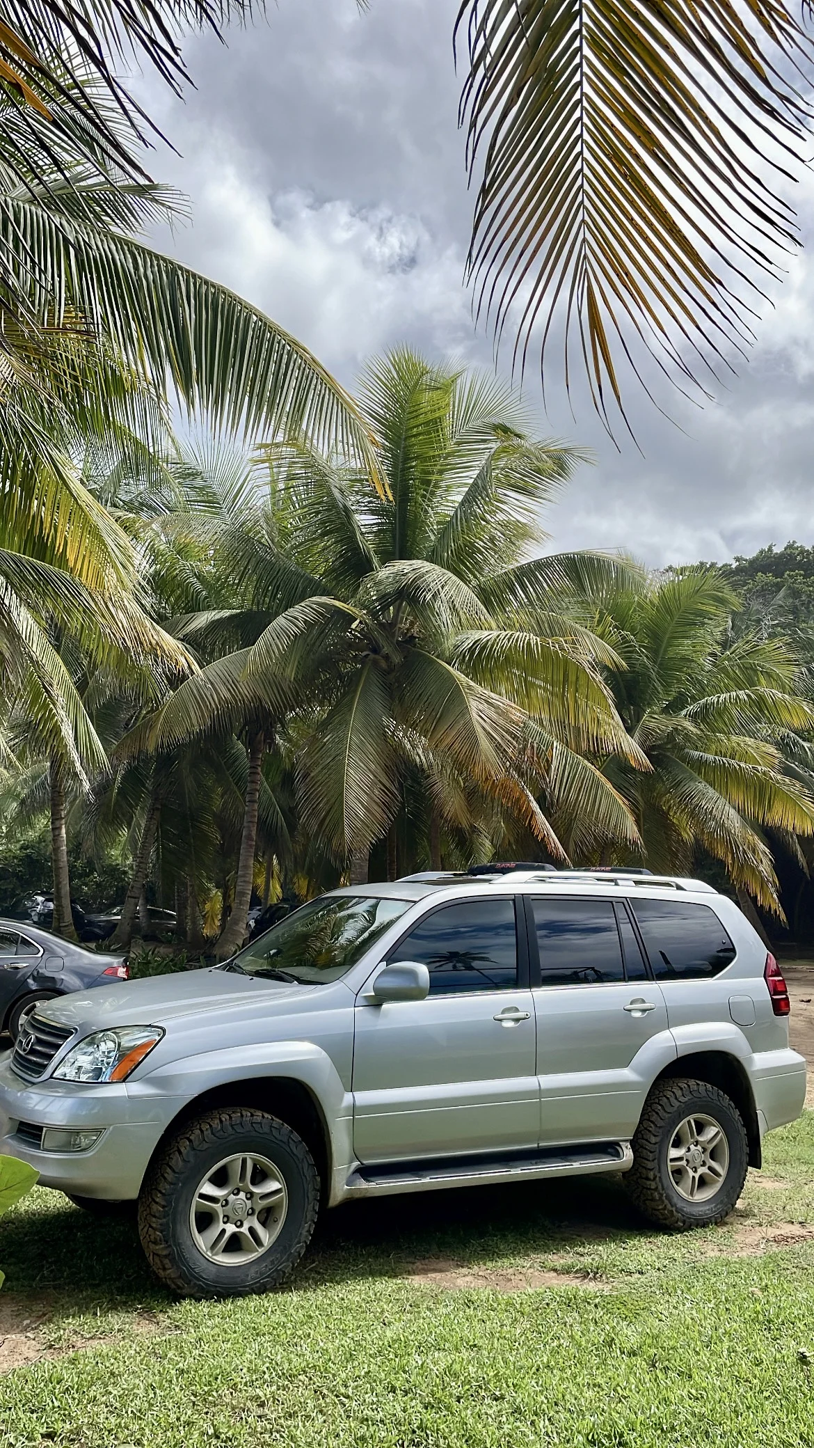

Eibach kit rides great! Didn’t realize how worn the original suspension was. 255/80 falken at3’s. Minor rubbing on inner front fender fixed with a heat gun. Spare in factory location aired down with a ratchet strap. 3/4” clearance to panhard bar. Stoked with the outcome. Tons of thanks to @Tanner H

What height setting did you use in the front?!

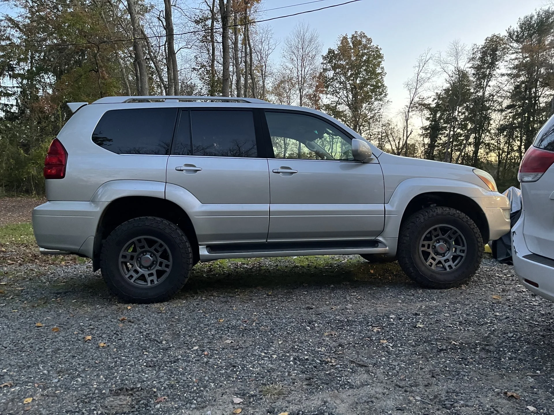

I actually just did this lift and went with the second setting. The front is a little low for my tastes and I’m considering moving to the 2.8” setting. I’ll attach a photo of mine. Mind adding one of yours. I also went with Blackhawk UCAs only knowing that they were $900 new and setup for a 2-3” lift, but I was able to get them off marketplace for $400 new from a guy who didn’t end up using them. Based on his build I assumed they’d be good and they are.
P.S. Amazon has a pair of Freedom Off-road UCAs in warehouse deals for $312 right now.
What setting is this at in the front? Thanks!
How do you feel about the Freedom Offroad product. I was considering those.
I'd pass unless they use an OEM-style ball joint and bushings. Otherwise, they'll be completely non-serviceable in the future when those components wear out.
