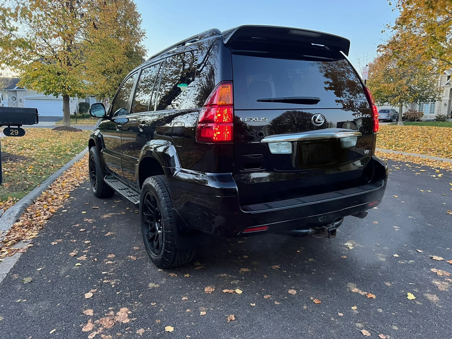

Hey guys,
I've had my 2004 GX470 for 5 years. At 135K my rear airbags failed so I replaced the entire suspension with the Eibach Lift Kit (part# 369-E80590050122). The truck now has 175K miles on it and the rear end feels unstable at times, like randomly it feels like it swings back and forth like a wind gust hit it. I had Toyota inspect it, they said nothing looks off but assume the shocks are bad. Is this possible? The truck has never been off road, mostly highway driving. I filed a warranty claim with Eibach but still waiting.
Any ideas if it could be anything else? Truck is making no noises, after market wheels and tires (20x9 w/ 275/55/20 at 40 psi).

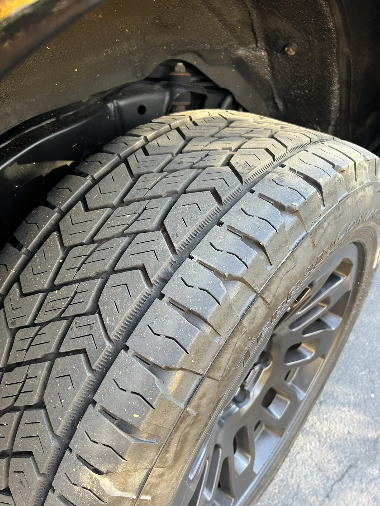

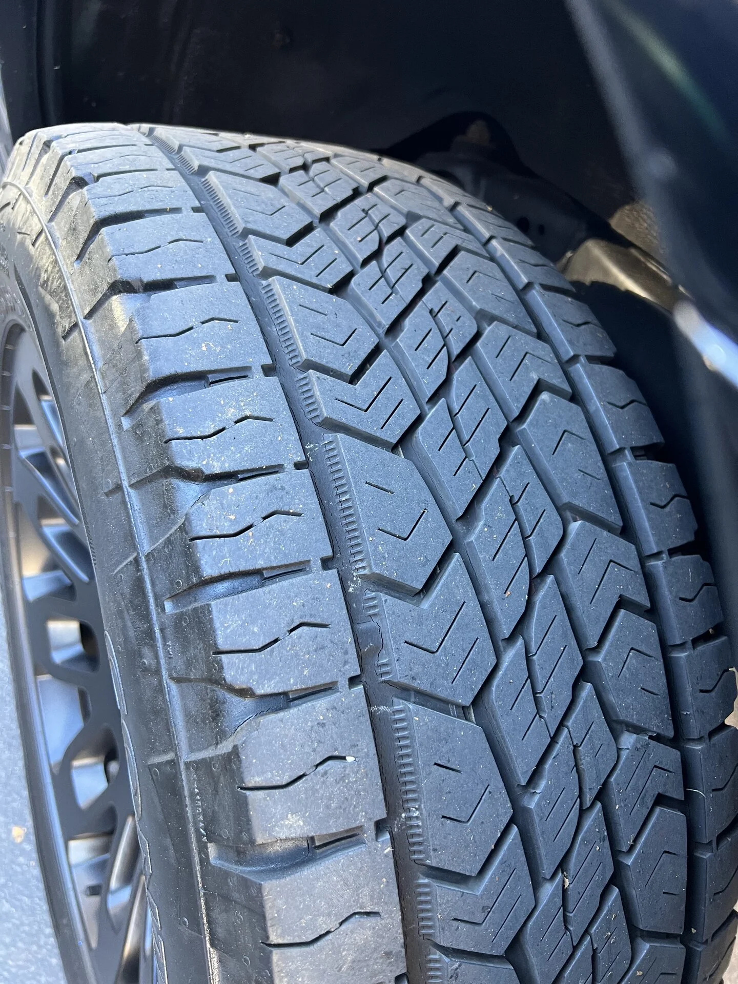

Tires can be a great representation of what the suspension is doing. Cupping on tires is a very reliable way to tell your shocks are not operating correctly. That can cause the car to feel very similar to the way you describe but that would be if just one shock failed. It also could be bushings failing but both of those issues aren't very common.

I'd be more concerned with your tires, they are dry rotted and need replaced.
