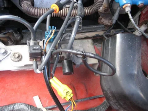

Here is the pic. The ground is connected but what is this plug that is with it?

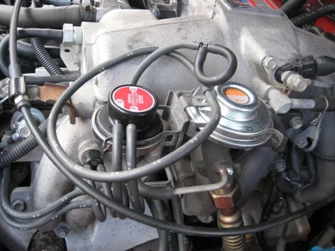

Also, the other pic. Is this crud saturated thing the PCV? Does it just pull off?

So on the EGR valve you connected the ports together, right? What about the hose coming off the egr vsv, what did you do with that?
With the EGR modulator you just plugged the port (Q) that goes to the EGR valve, the single port in the back?

By looking at my manual, it's the line going from the egr modulator to the egr valve. plugged the modulator. egr valve to the vsv (for egr) removed that line and plugged the vsv (for egr). the line that went from egr valve to modulator i wrapped that line around and plugged both sides of the egr valve. if this doesn't help, i'll snap a pic. ryan

Is bypassing the EGR like in the photos the same as removing the system? I need to keep system installed for emissions test every 2 years till the FJ is 25 years old.
I had the same result. I capped the four fittings effected by the bypass in your photos. It seemed like the idle smoothed out ever so slightly, the same with the surge at 2500 rpm. But both issues are still there. Thanks for the heads up on the 3FE group, I will check it out.
