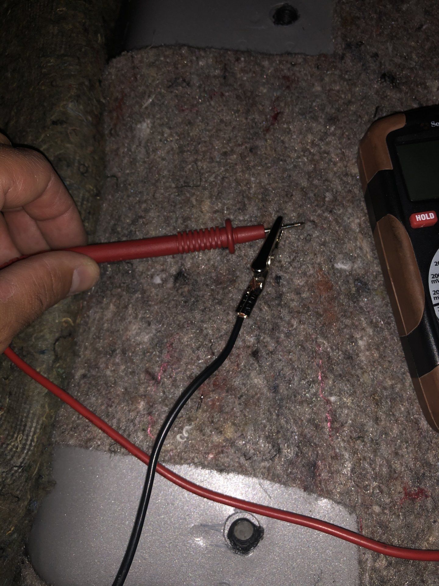

Ok, I think I did this correctly. Alligator clip and wire from + post on battery to + lead on multimeter. Touched negative multimeter lead to ground point on top of fuel tank and measured 12.8V.
can u take a close in shot at the blue wire and white wire. from the photo, i see that they going to the same pin.
leave everything connected. Put the Positive lead on the Blue Wire and negative on the ground point on the fuel pump cover. Crank the car, check to see if you see the 12v
Use a test light for your voltage checks. Volts mean nothing, the test light will measure/show you have voltage when a load is provided. You can have 12 volts but no amp/load ability. I have found many a problem like this and it’s usually a corroded connector that slows no load voltage through, but once load is placed on circuit you get nothing.
