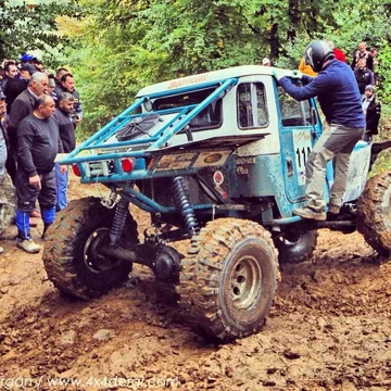

currently I'm using Edelbrock THUNDER SERIES AVS 650 cfm. I'm having problems, especially the nose down. is stop the car. I'm falling holley to receive. Waiting for your comments. or holley efi, atomic efi,???

Edelbrocks are terrible off camber. Hollys are not a lot better. QuadraJet is about the best off road carb I've used.
EFI is far better. The FAST, Holley or other aftermarket are easy to set up and run well, but they are very expensive. GM TBI works great, is cheap and there is a lot of info on it out there, but it's not 100% bolt on.

the car is stopped constantly leaves me in a very difficult situation. especially in descent and peak output. Well, if we give up carburator .. I have to choose which system efi

Q-Jets are better than Truck Avengers off-road, but you still can't beat EFI! If you are competing then get EFI. Period.
My personal experience with Q-Jets is they do very well off camber and down hill. They can stall going up hill if at idle (too rich), like while waiting for Josie's Land Cruiser to get out of your way.

The Edelbrocks the floats are on the sides, pointing towards the rear. When going down the gas rushes forward to the front of the carb,floats drop down and open to let more fuel in. Not a good carb for what you are doing. Quadrajet the float bowl is in the middle of the carb. Much better for off roading.

I have the off road holley on my red fj40 (it was on there when I got it), Even with Jet changes they suck fuel, runs great on the road, good cold starts, ok for a driver or a desert truck, just not the thing for rock crawling or alot of off camber stuff.
