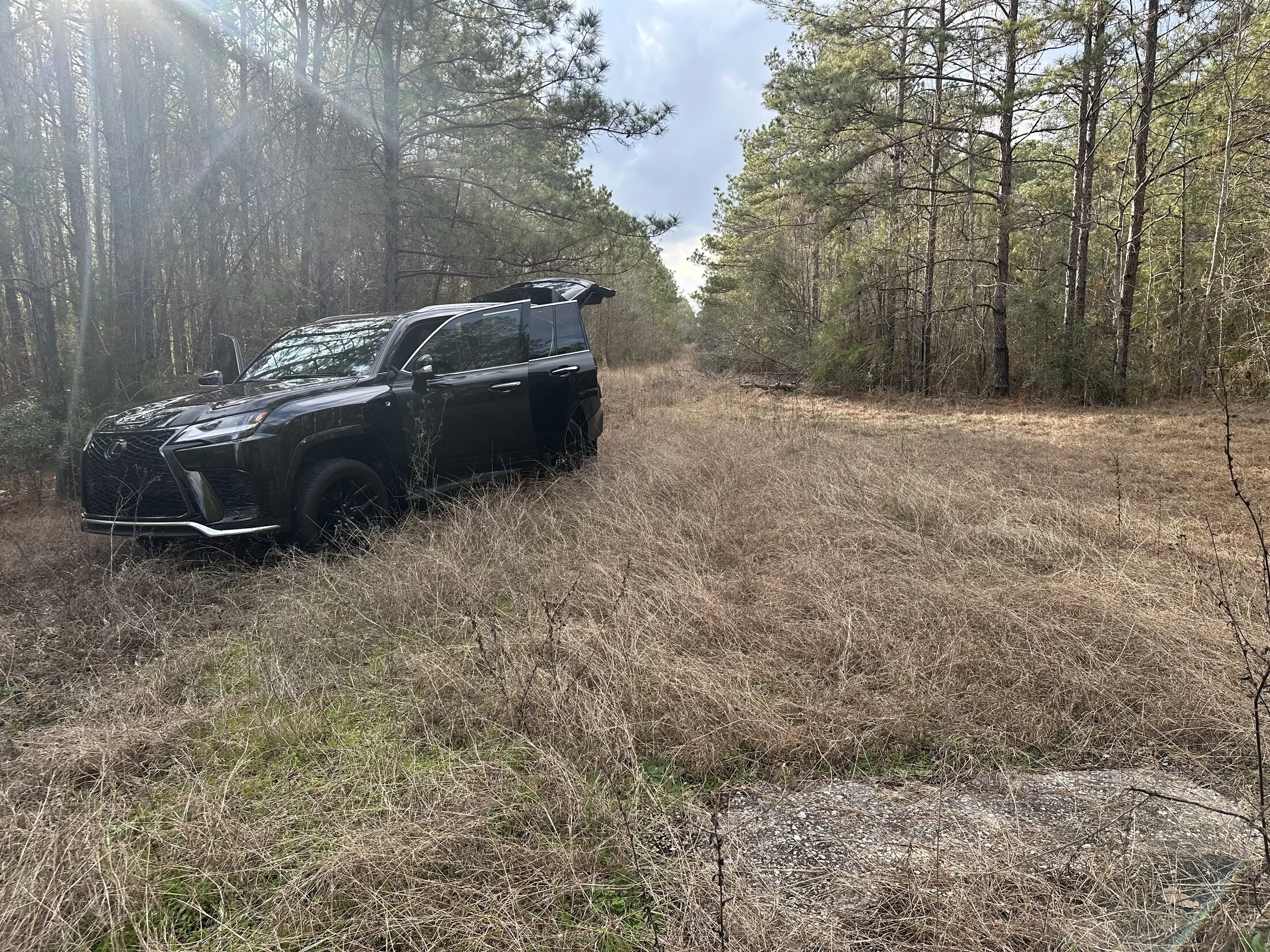

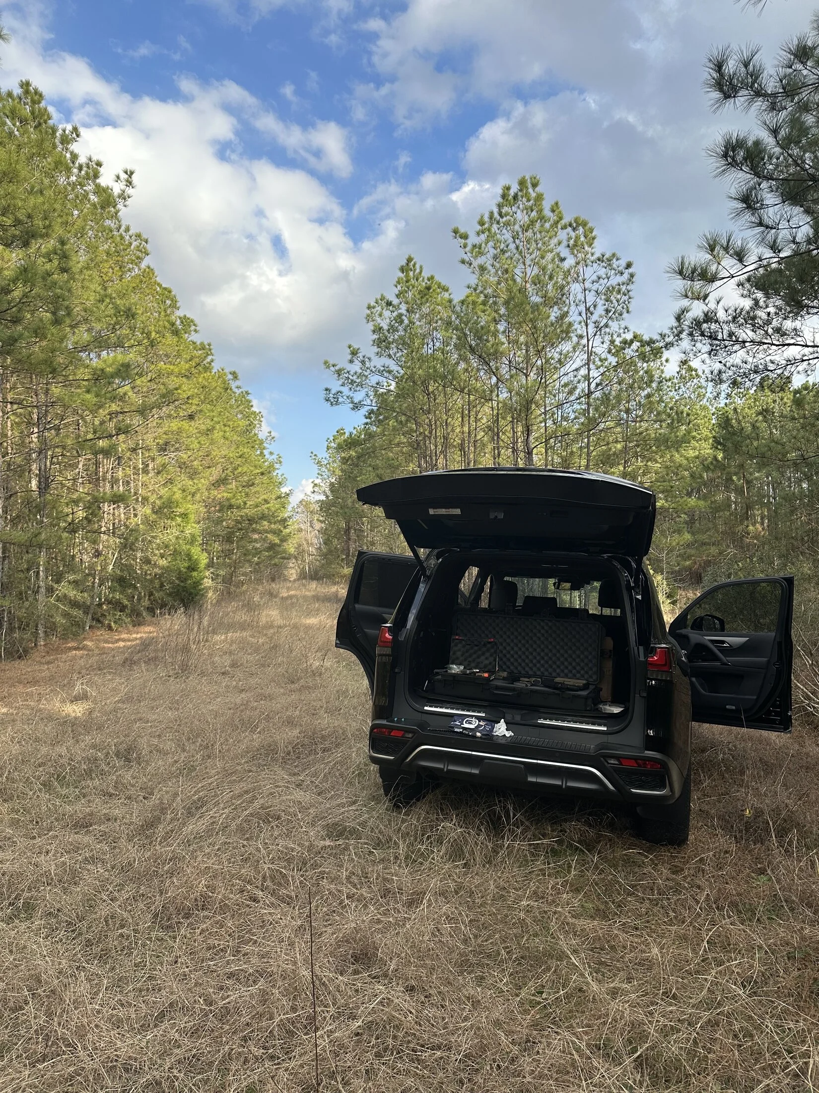

Gratuitous off road and activity pics. Spared the ES350 loaner.
