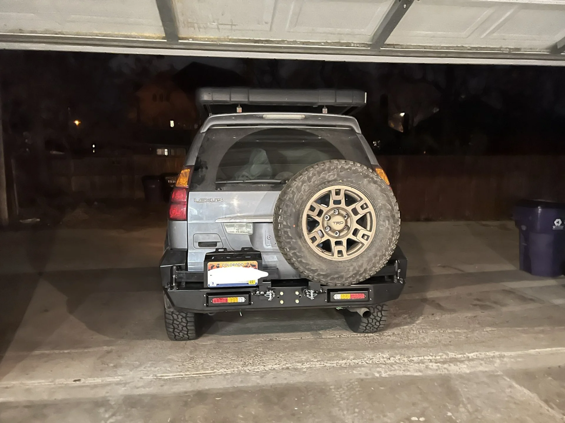

Better than expected.
The good;
- Fits well
- No rattles / squeaks over bumps on test run
- Slimmer profile than expected
- Wheel is low and does not block window
- seller responded fast, and offered some money back for minor issues
- total time took about 5 hours including trip to store and dinner, not including light wiring… saving that for another time
The bad:
- tire carrier did not fit into mount without a sledgehammer installation
- No instructions made install a bit of a game. Lights go on first, had to remove bumper after realizing that.
- Some chipping on powdercoat in shipping.
- Flimsy corners (bumper wobbles with tire on, swingout in open position)
- Lugnut studs came as m12x1.25… not standard toyota… but they sent m12x1.5 lugs. Had to get lugnuts at oreilly to mount tire
- Some missing hardware
- lights are cheap garbage that I cannot imagine will last long, which is a bummer since replacement requires bumper removal.
- Does not appear factory hitch works, but I have the little POS one that mounts to bumper steel
- Had to drill for license plate, holes are not spaced for US size plate
- license plate bolts poke into Nato can holder, will require some care when using or bolts will likely wear a hole into fuel can
- Rust will come soon, guaranteed
Overall, not bad for $1300 but you get what you pay for and it’s a cheap bumper made in china.

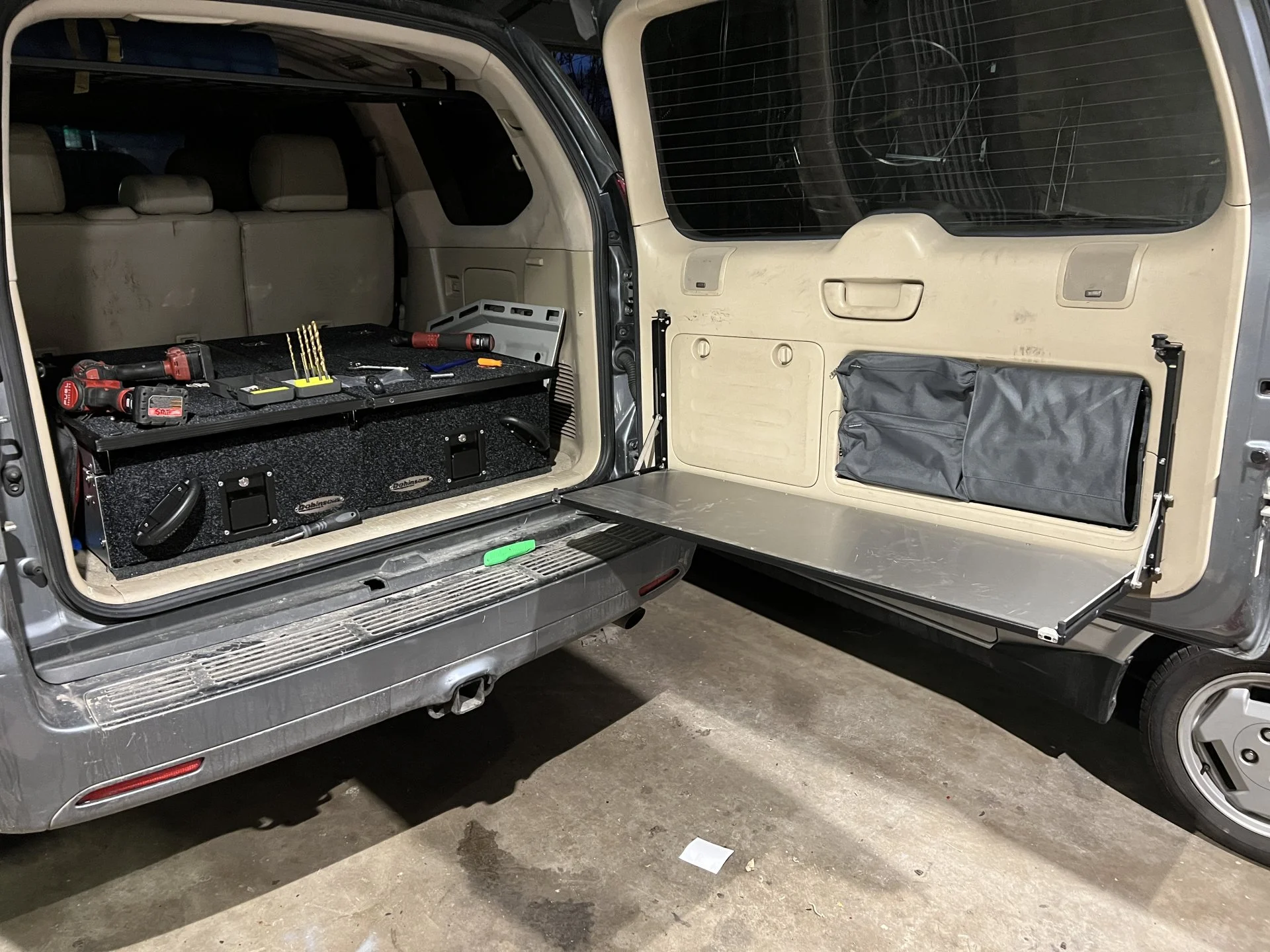

Threw in a bunch of Bison Gear bull**** and finally installed my Dobinsons drawers a couple days ago too.
Thank you! The bumper doesn’t look too bad! Only time will tell on longevity. Lot of bumper for the price. Curious if a frame mounted trailer hitch will fit with it. I gotta have a hitch. Nice truck!
How do you like the dropdown table?
What's the vinyl thingy??
It’s a bag for storing little things. Bison Gear makes it.

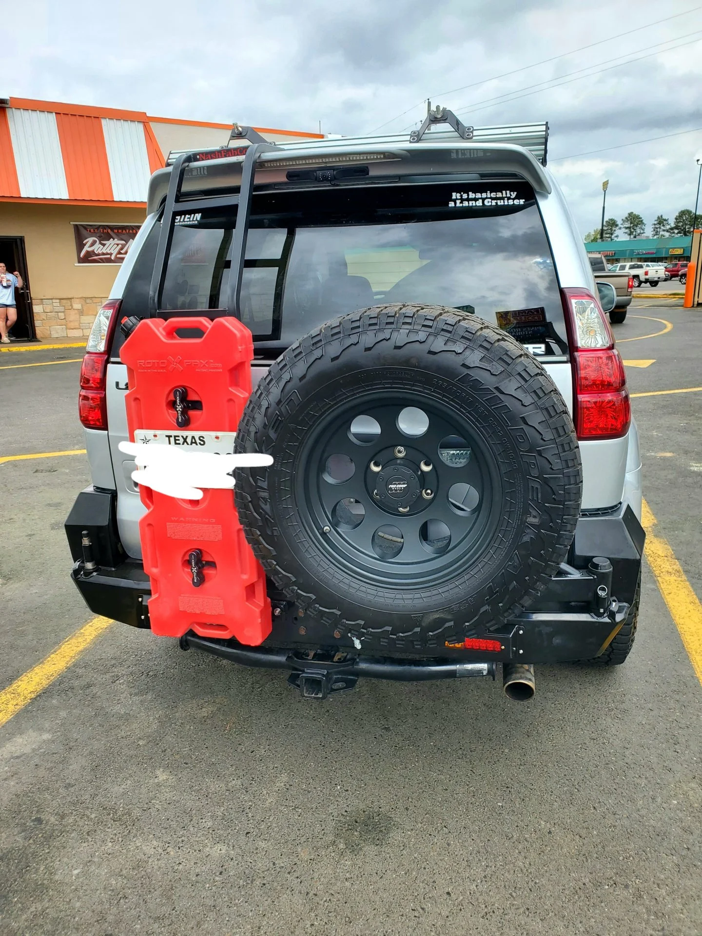

Installed my bumper yesterday. Agree with JT almost to the letter down to sledge hammering the tire carrier in and wrong lug nuts.... Pleasantly surprised at the packaging, and fit. More robust than I expected, but likely to chip and rust soon.
Frame mount receiver hitch absolutely fits and works without interference, but must be removed and installed over the bumper as they share mount points. 7 pin connector required some notching, but mounted back in its original location. 2nd swingout will prolly interfere with NashFabCo ladder so I skipped it for now.
Threw in a bunch of Bison Gear bulls*** and finally installed my Dobinsons drawers a couple days ago too.
That actually looks pretty good. I have the Metal Tech and it still involved a lot of pounding, fab, and other unorthodox installation techniques. This is partially because my 2004 GX has >300,000 on the clock, but also some poor design and poor attention to details in the factory.
