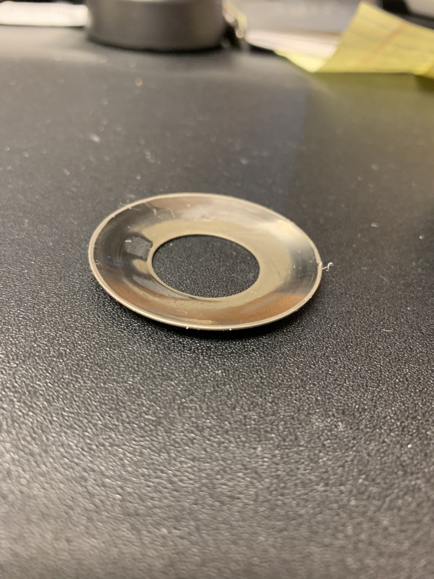

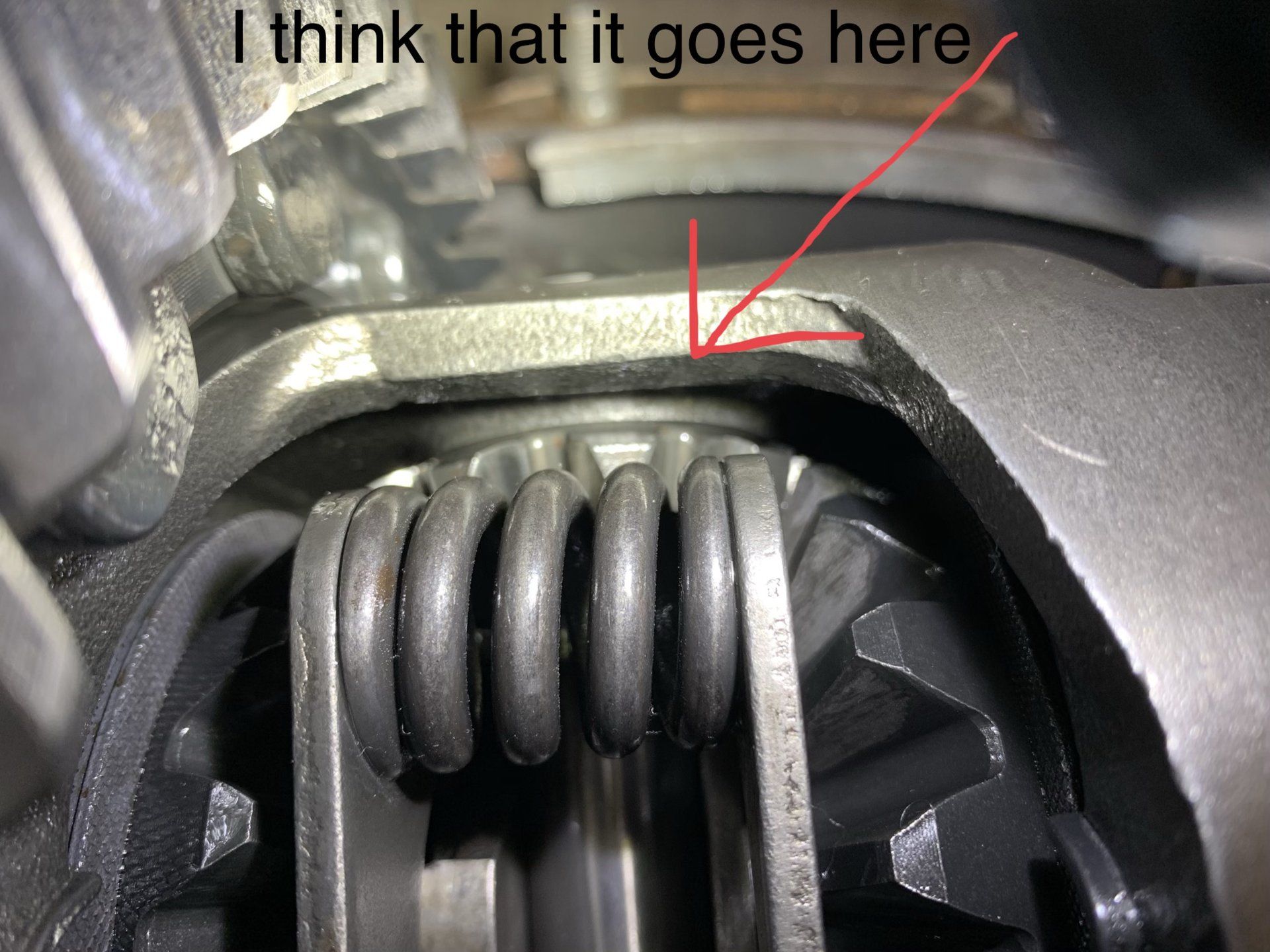

I am in the middle of a rear disk brake conversion.... I finished putting the axles back in and was cleaning out the bottom of the diff when I found this! I believe that it is a shim for the small gear that the large pin is inserted through. Is it possible that it fell out while I was pulling the axles or has it been riding around at the bottom of the diff ever since the PO installed the Eaton LSD.
Any suggestions on how to put it back where it belongs?
You should have a thrust washer (that’s what that is) on either side ... just one on each small gear (spider gear) ... afaik
Edit: look and see if there is one on each ... I would imagine that yes it can fall out ... usually do slide around easy on a normal diff :meh:
Anybody know where I can get my hands on a Eaton service manual? I’ve got to figure out how to disassemble this locker to get the thrust washer back in.....
