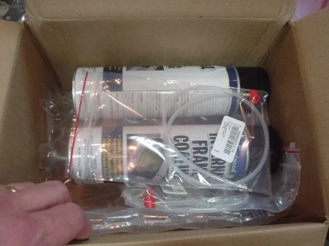

Got it today - Saturday - so I took a break from catching up on Gobernment paperwork to try it out.
Got two cans
Each came with it's own nozzle with the hose attached with a barbed fitting and the sprayer in the end.

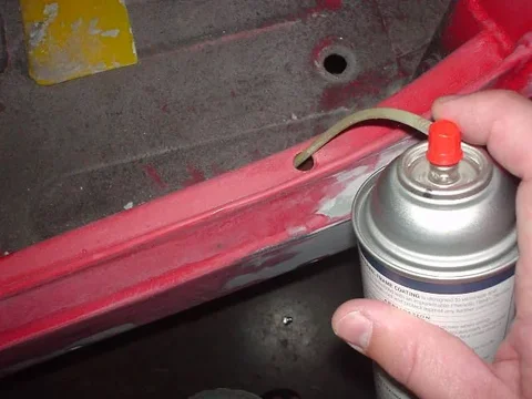

The first application was inside the upper fender. I had cut a hole in each side to install a scab plat for nut plates to attach half doors.
Made sure I shook it good and sprayed it easily. It is very thin and I had not problems with clogging. It ran out of the seams like they mentioned.
