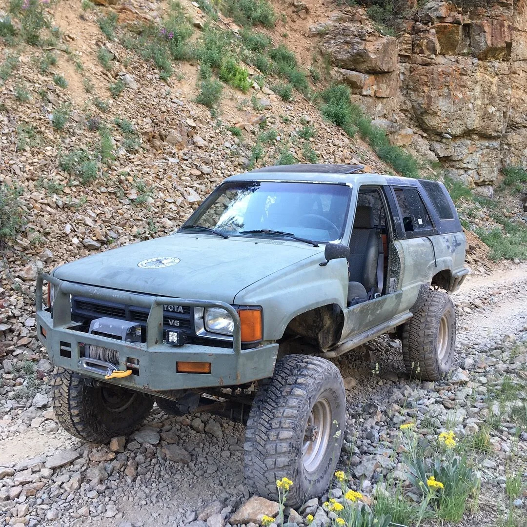

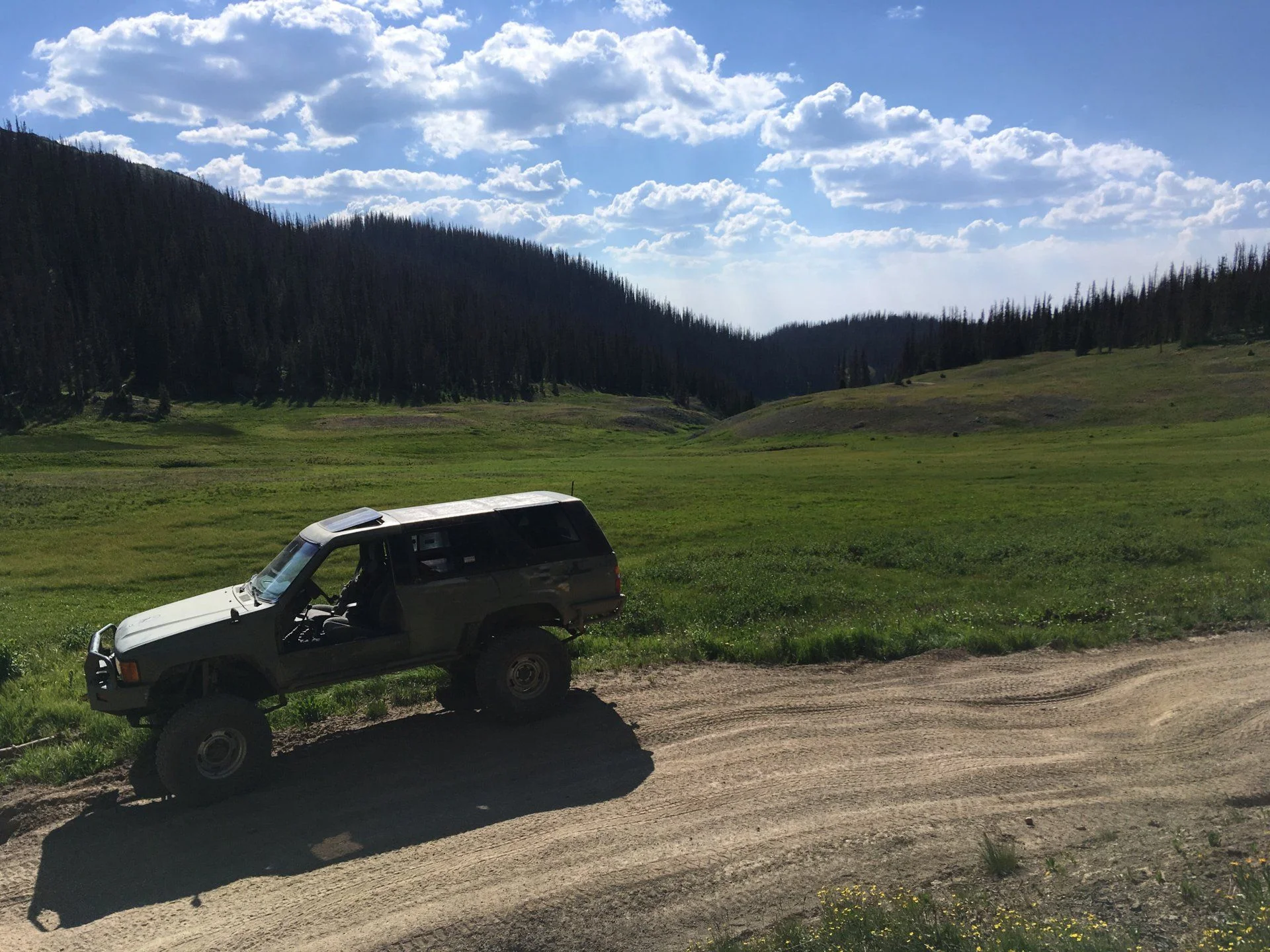

2:30 pm I unloaded the 30 year old, questionably reliable, 178k mile wore out 4Runner at the East Fork road on the San Juan forest.
Just before the first stream, brakes failed. Somehow I managed to break off a line at the caliper, which is odd because the trail to that point is not super rough.
Managed to plug the line with a bolt from my random assortment of spare hardware.
Wheeled the whole rest of the trail and back with three brakes. Excellent day in the very dry forest.

How did you know you had a problem? Did the brake pedal go to the floor? You must have had some extra brake fluid?

@Chompers I got lucky, it was the only bolt soft enough to cross thread in and actually seal. Its been on my list to make some brake line plugs, need to push that to the top.
@evanz80 the brake warning light actually came on, as I stopped the pedal faded. Yep got lucky, I threw in the large bottle instead of the small one that had been in my gear. Lucky again.
