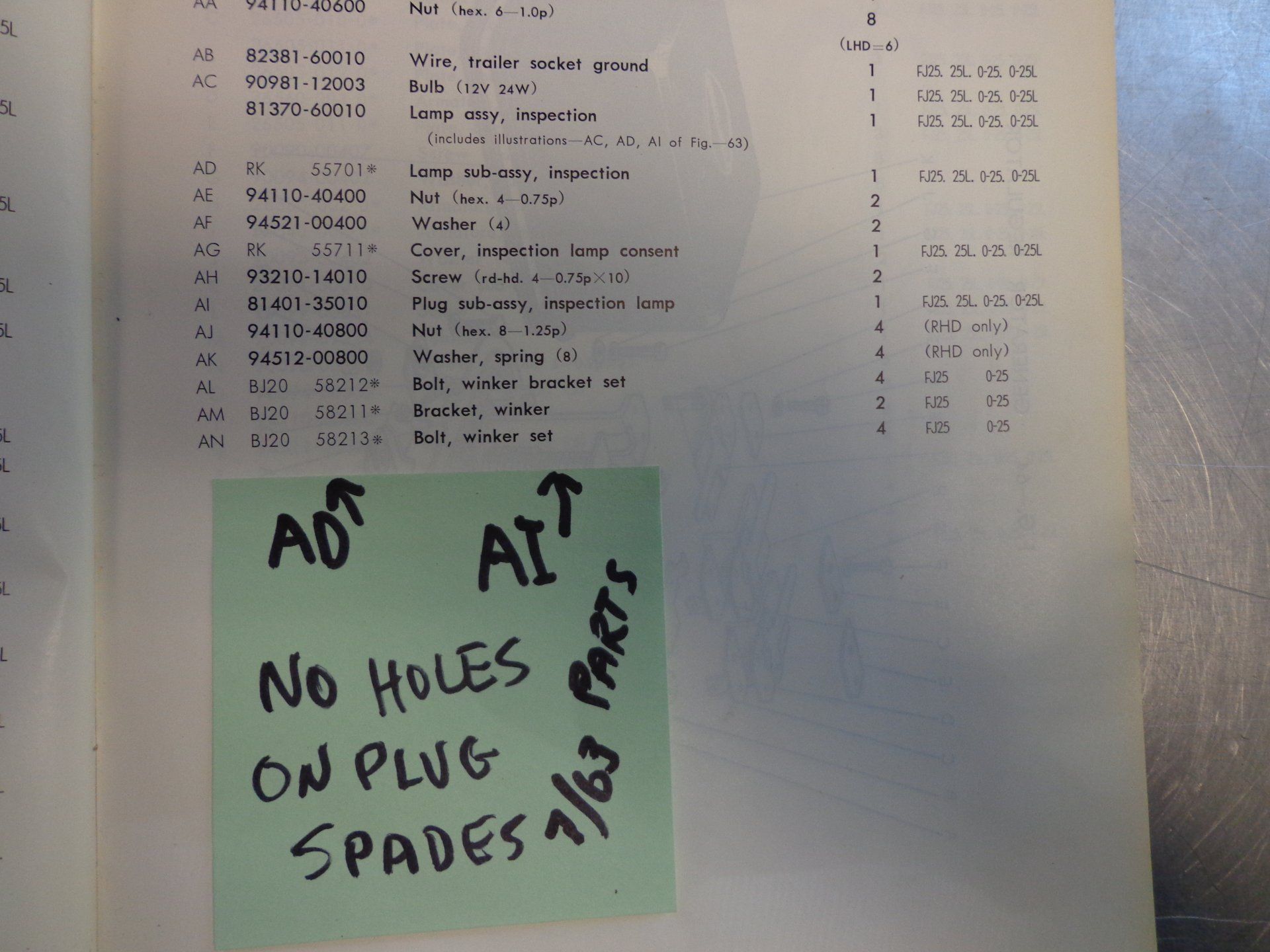

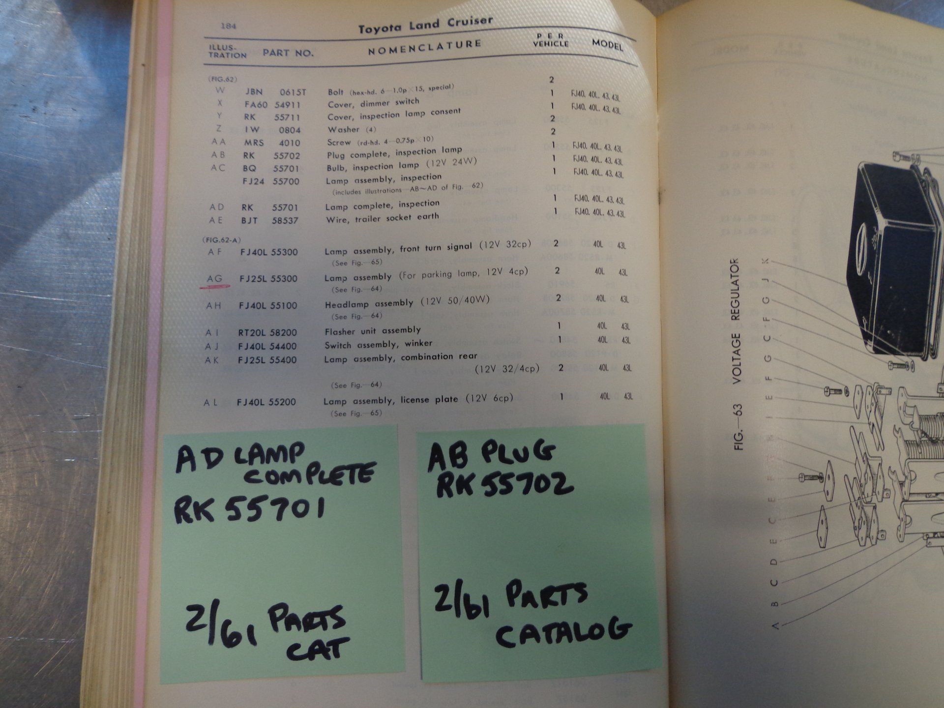

Learning more about early inspection lights, not sure when the plug was available separate or molded in.
All of the early sockets and cages look to be the same.
I am noticing differences in the plugs whether they have holes in the spades or not.
Here are some findings from some parts catalog's I have.
1/58 FJ25 catalog does not list the plug separate, no holes on the spades
7/63 FJ25 catalog plug is available by itself, no holes on the spades
2/61 Fj40 catalog plug is available by itself, holes on the spades
None of these show a blue plastic pouch
here are some photo's. Thanks, John

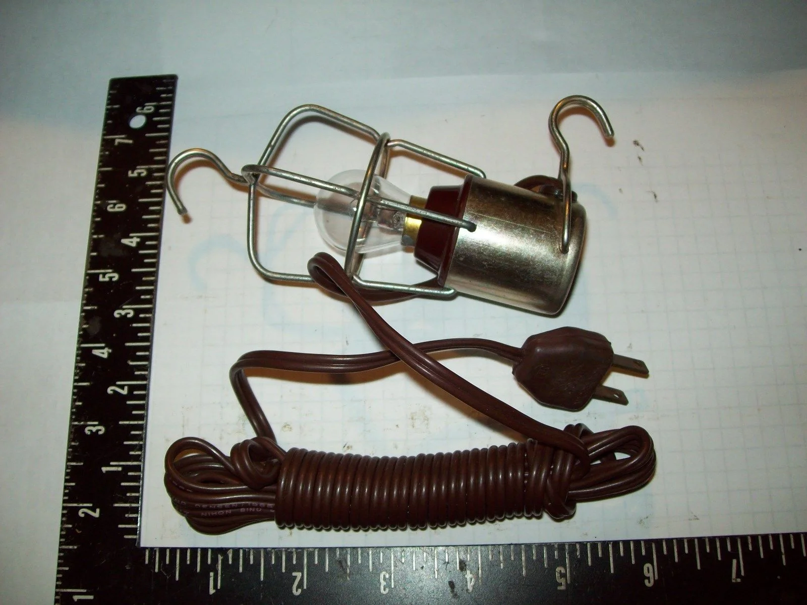

The marking on the cord may be useful for identification.
This lamp with the molded plug, has the cord marked NIHON BIND DENSEN 1965.
Marking detail
This lamp, also with the molded plug, has the cord marked TOKUDEN.
