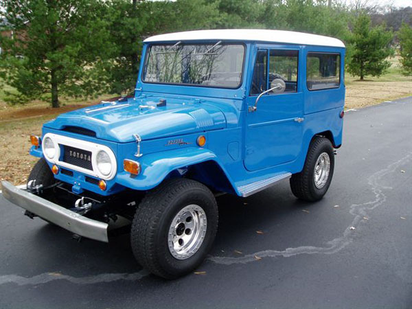

I've seen '69 FJ40's with round fender lights and some with square lights....can someone tell me when they went to the square lights on the '69 or were the square lights for a specific model?
Round
square
1962-1968 : Round Turn Signals, (with round parking lights on the front under the bezel until October 1969)
1969-1974 : Rectangular Amber Turn Signals
1975-1984: Square Box Amber and White Turn Signals
From Specter Off Road
sor.com
12/68. Rectangular turn signals. Bib lights. Side reflectors. 2 barrel carb with post thru the center. Air filter matched the carb. Retard distributor
