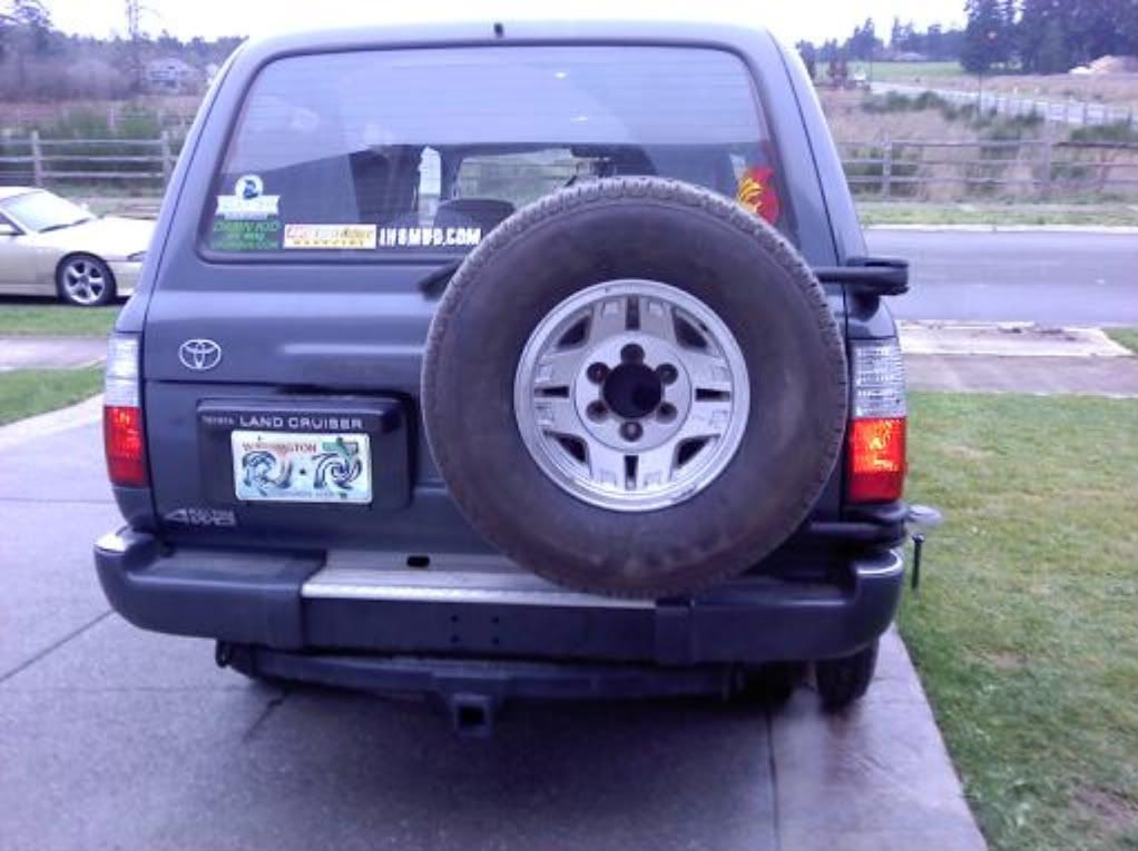

Could someone running these on their 80 run out and snag a quick pic of their wheel?

edit:..yeah thats the rim im talking about. cant see the offset stamp though

The pictures that I posted of my 80 are 15x7 OEM rims. TOYOTA didn't make this rim 8" wide

His pics aren't close enough to see the stampings. I think looking for a FS thread could solve the mystery once and for all.
