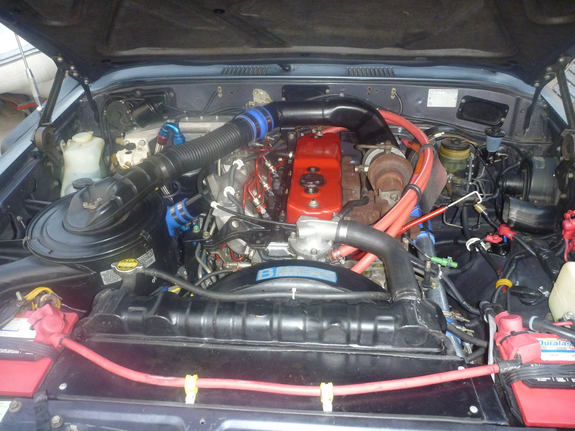

I swapped an Isuzu 4BD2tc into my 60 nearly 10 years ago and have been very happy. The engine is a 3.9l inline 4 with about 135hp and 250 lbs torque. It is turbo charged and intercooled stock, and has worked out very well.
All the Japanese engines in this era share similar designs and many of the same parts like IP's and injectors. This engine was designed to push a Isuzu NPR cab over wheels box truck that weigh up to 15,000 lbs. So it easily moves my 60, even with a full load.
I can fully load the 60 for a multi day trip with 3 people, 3 dogs, full roof rack, etc, and go up the Grapevine on Highway 5 Southbound on a hot summer day in 5th gear with the AC on at 70 mph! Oh ya, I have averaged right at 20 mpg over roughly 55,000 miles!
I think the 14 series would be similar in performance, and you would be pleased with the performance.
