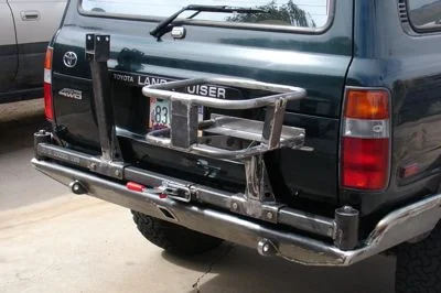

My friend and I just finished welding up my rear bumper. I am considering either powder coating or just rattle canning it. I going to get a quote tomorrow. I may just have the arms and carriers powder coated and then rattle can the shell for ease of up keep.

Thanks for all the suggestions. I just got back from the powder coater. $200 including sandblasting. I am going to powder coat. There are so many options, but I will be going with a textured one for sure.

Great looking build up on that bumper!
Drew
Sadly I can take very little credit for this bumper. This is a DIY 4x4Labs rear bumper kit from Luke Porter. Essentially we (several others in AZ) got a pallet of pieces that we are in the process of welding together. If you have the tools it is not a hard project and takes a full weekend to get it to where you see it. There are parts that require two people as that sucker is heavy! Luke has done an amazing job with this kit. I don't know if he is planning on continuing though.
My friend Alvin (MaddBaggins) helped me get mine assembled. I helped him do his first and then we tackled mine next. My welding skills stink, so he did the welding and I did the grinding, test fitting and cutting when necessary.
