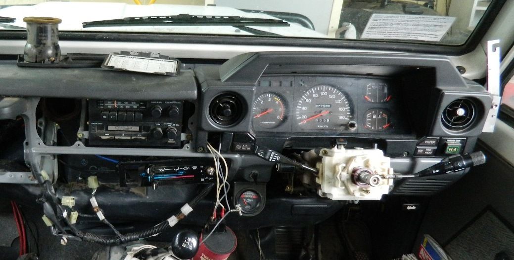

G'Day Fella's,
The cassette player died years ago and I can only pick up AM stations on the radio, so I was thinking of installing a new (single) CD player, with radio etc. This is on a BJ73 TLC.
My #1 dumb question is;
#1) Will the new stereo systems bolt directly into the soon to be vacant hole in my dash (see attached image), or come with an adapter to achieve this?

most stereo's will have provisions to bolt in to the factory brackets, you will need to buy an install kit as most stereo's today are single DIN and yours looks to be a double DIN. Also is yours a 12v or 24v set up, it will take some wiring to make a 12 work in 24, and then it will be a constant drain on your battery. it very do able i have had it for a little over 2 years and no worries.
even the double din brackets should have at least one hole to match the new radio.I used one existing hole and punched a thread for the second one.
for single din radio like kienzle, the single din fascia is a bit narrow, I had to file bit of plastic out of fascia.
no matter which way you go, do not use an universal adaptor on the fascia. use the dash brackets you have allready, they are solid. Since you will fix radio first, then come with the fascia, u need to make them fit. Thats where I had to file.
also, the toyota harness normally needs an adaptor harnes to match modern radios.

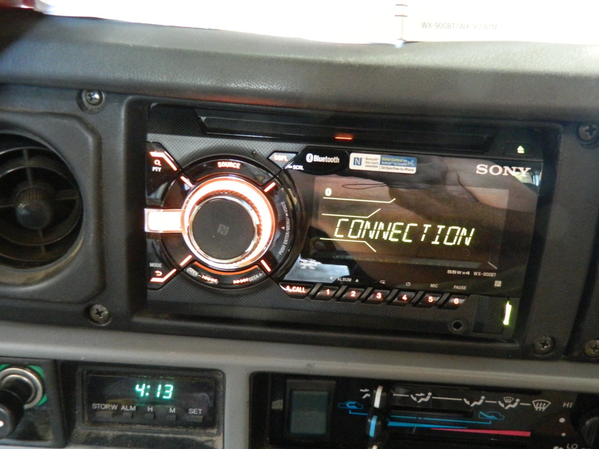

G'Day Dprio34,
I too was looking at a Sony double din model (part # WX900-BT), so thank you for that info, much appreciated.
