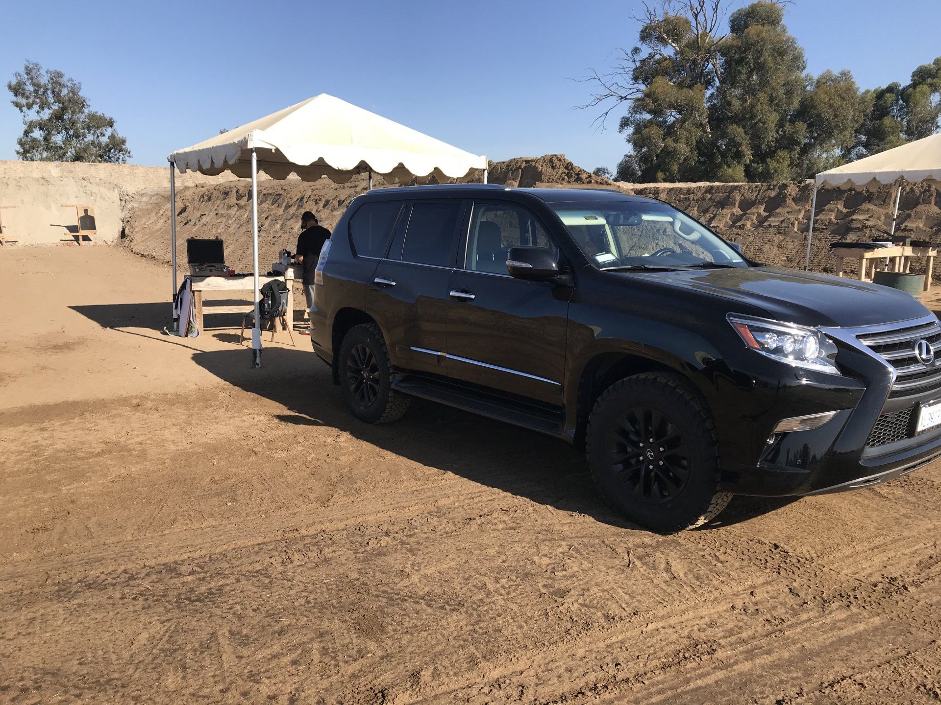

Did Lexus release factory black wheels like the ones on my GX below? I just looked at the spare, and it isn't black, which is going to be an issue when I get a tire carrier and put it in rotation. If it's factory, where can I get a wheel? It doesn't look like Plasti-dip...
It's kind of hard to see the pattern in the picture to be sure what you have.
For sure, Lexus never came out with a "black" wheel. Dark grey's which had some fancy name, silver/chrome but not black.
It kind of looks like a GX wheel since it has the "L" on the center hub. Are they 18" wheels? That's the only diameter wheel the GX has ever come with.
If you go here: GX 460 Manuals
Post #3, it will have every year owners manual and I believe there should be a post about options available which would include wheel options.
But in short, Lexus never had a black wheel for GX's. If you can, take another photo with better lighting and a little closer!

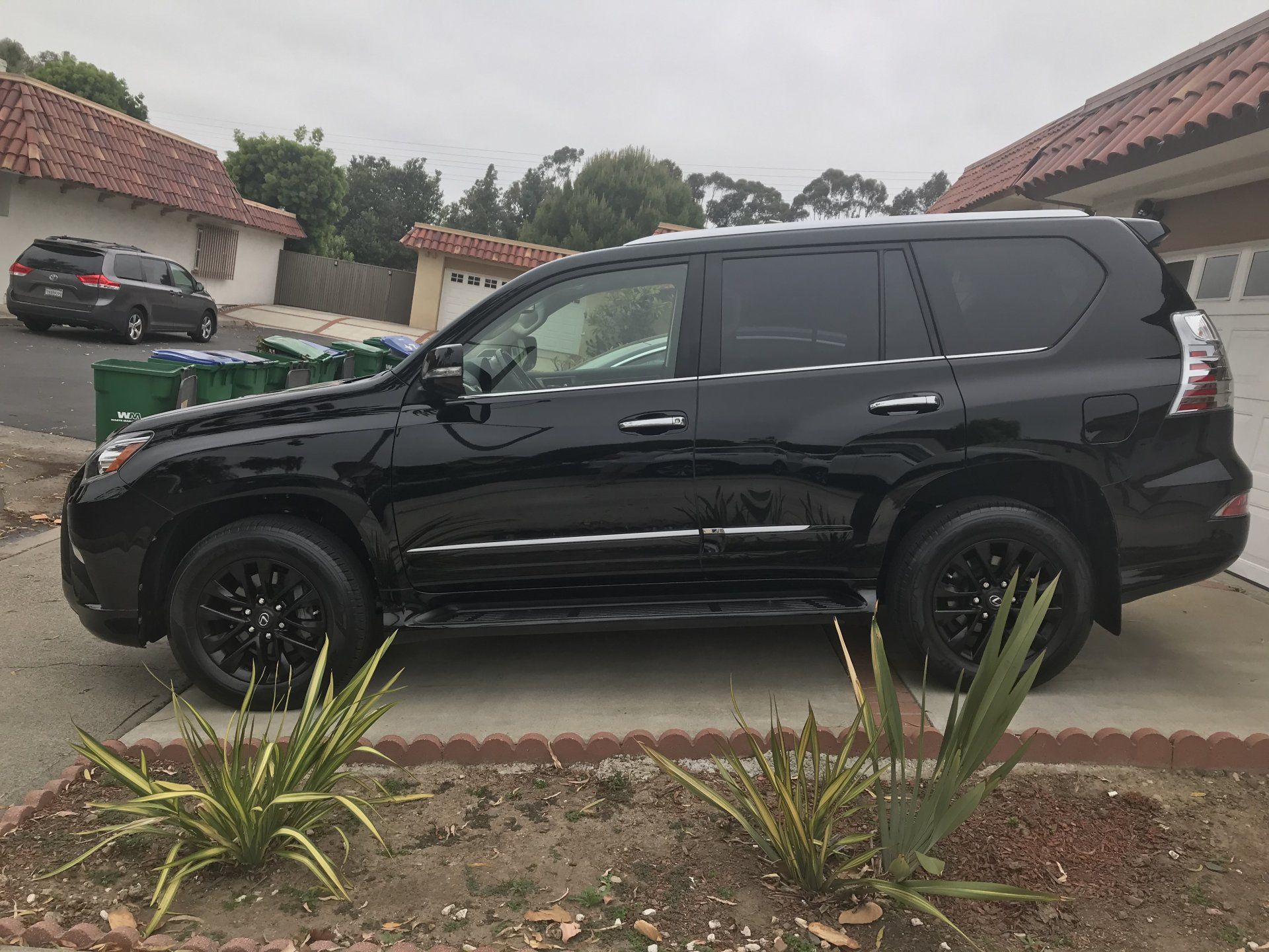

Another shot pre-tires. Definitely 18" in the factory design, but it sounds like they were painted/powder coated. Bummer. Any ideas on how easy it would be to match the spare to these? Possibly get all 5 powder-coated to ensure a perfect match?
I've probably got 100 miles on the BFGs, so I don't really want to step up to the end goal of 17s on 285/70/17s, which then pushes me into a lift and body mount chop at this time.
Hard to tell from pics, but I wonder if the PO used the Lexus Black to color match them. I’d start there. If they are painted, a good body shop should be able to match them close enough that you won’t be able to tell.
I've seen some that have been painted (owners and dealers) but stock from factory ....gunmetal metallic or dark gray is as dark as stock rims get.

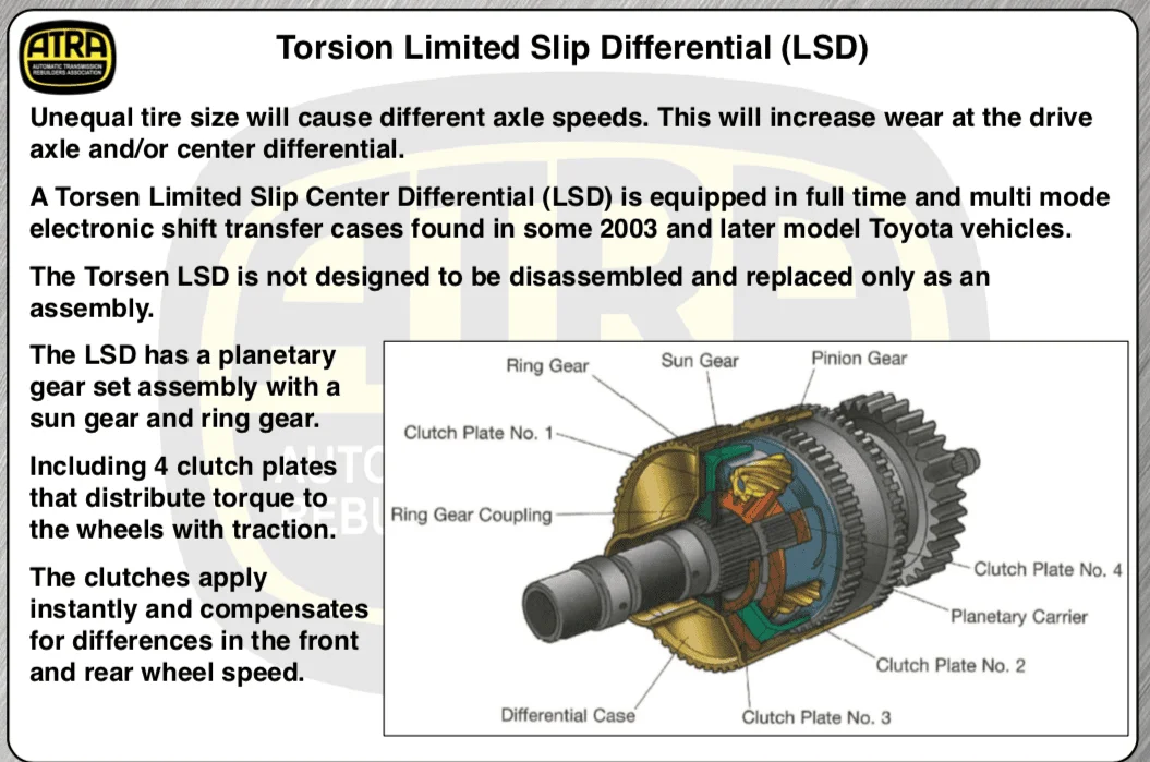

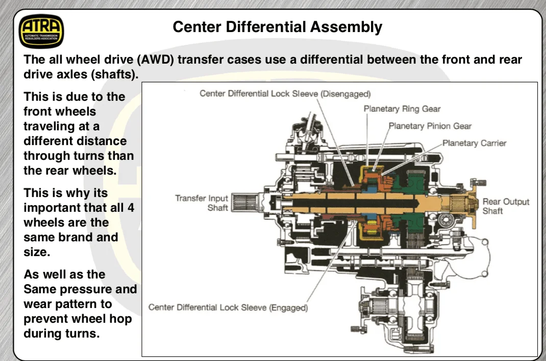

r2m: I never had this happen to me on my former Explorer but a surefire way to take out the Borg Warner 4404 AWD viscous coupling in the '96-2001 5.0L AWD Explorers was to use a tire out of spec from the others. This was a completely mechanical system.
I did send Torsen an inquiry on this subject late last week. I will let you know if I hear anything back about concern as it relates to 460s.
I'm certainly interested in hearing what, if anything, they say. My wife had an Audi Q5 (2010), and it - like many new(er) AWD SUVs from Audi, BMW, MB, Volvo - did not have a full size spare. Rather, a doughnut that was MUCH smaller than the real tires/wheels. I forget specifics, but the owners manual allowed something like 100 miles of continuous driving as long as speeds were limited (to 50mph maybe?).
The X5 Xdrive (AWD) she has now has the same small doughnut instead of a spare, so the AWD system must be capable of dealing with the rotation speed differential - otherwise they wouldn't risk the warranty exposure.
