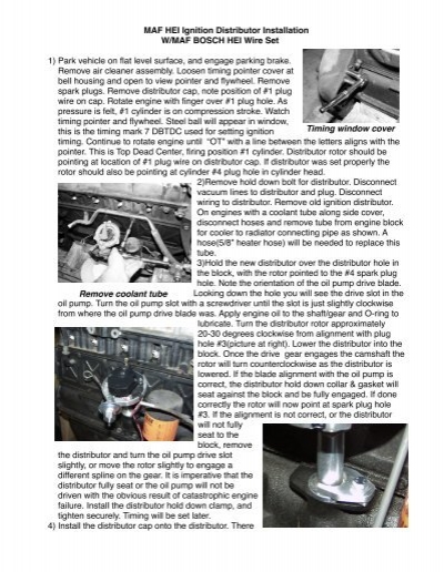

DUI distributor (semi vague install instruction) specifies needs 12V constant, and tach hookup (2 prongs on dissy)
The dissy I will be installing.
MAF “ lightning strike” install instructions (more in depth on install process in general)
I realize these are technically different objects. Putting it here for reference. Again needs 12V constant and Tach (2 prongs on dissy)
Are the relays and whatnot some folks are running extraneous? There are a lot of knowledgeable users here. I assume these installs are not just peoples ocd about how things should be done. Sorry to start a thread about a possibly dead horse.

Turns out you only need tach and batt to run these (like the manufacturer suggests).
