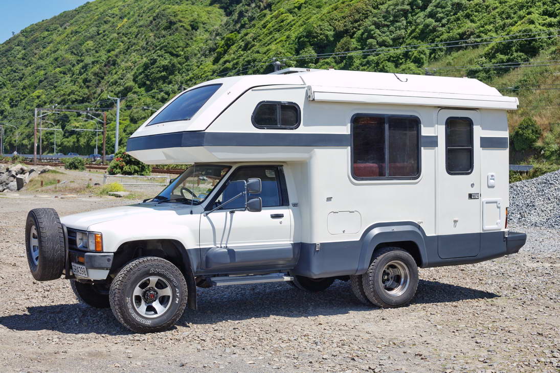

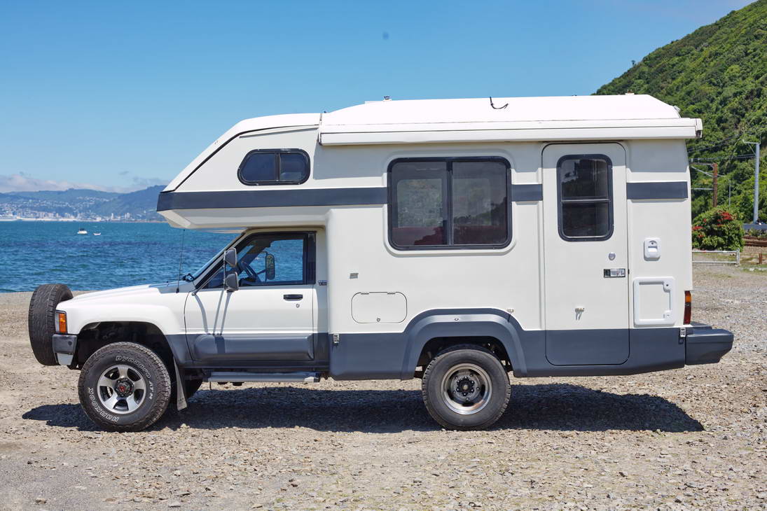

Well total weight is in the range of 3t for the rig and most of it is on the rear axle. Therefore they originally came with a fake floating rear axle and duallys. However mine got modified at some stage with a series 60 axle and single wheels running on 50psi 8ply pirelli tyres 245/70R16. and the rig feels really floaty. Too much weight on the rear axle and the foot print in not big enough. So going for duallys and min 12ply tiers is my goal to spread the load and improve ride comfort
I know that there is 1t Toyota dually axles out there and other RV's on duallys. However I first would like to see if I can’t make it work with what I got and that is a series 60 axle.
this one is like mine just with single wheels at the back
88 Toyota Hilux Global Galaxy 4x4 camper
