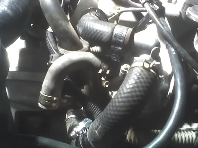

Its a crappy picture but here are the 2 bolt holes I was speaking of.

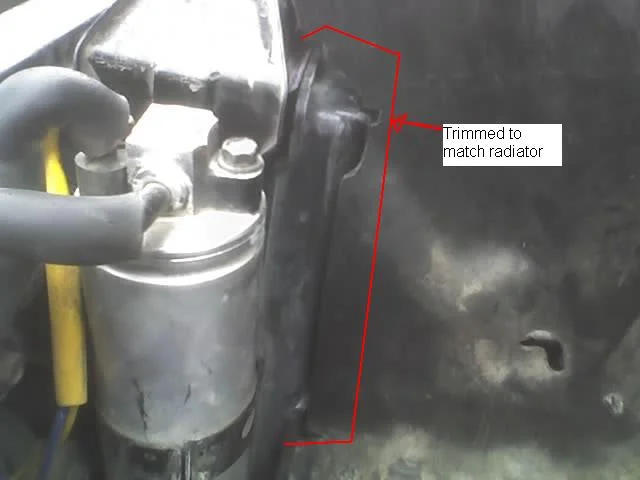

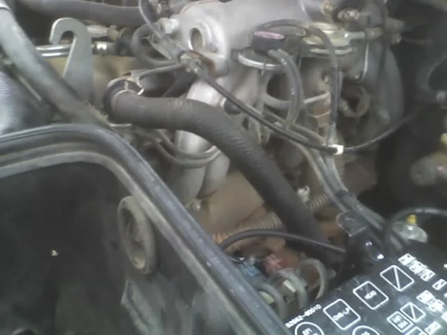

I go t some pics today. Excuse tohe quality, they are form a phone and it was cloudy out.
More:
The last of them:

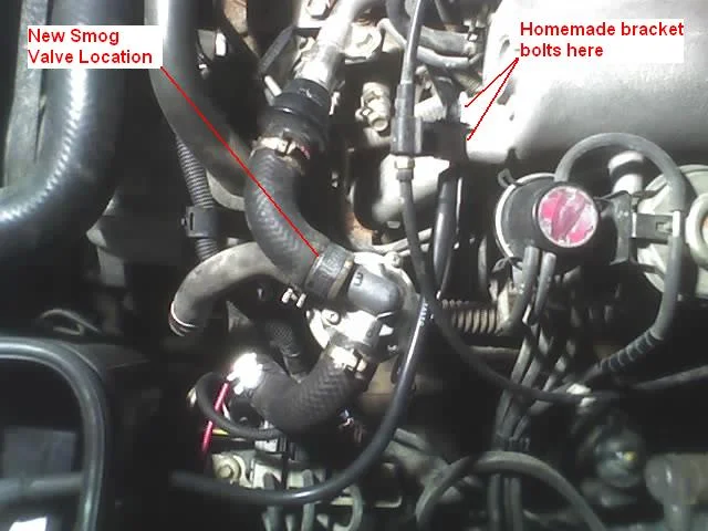

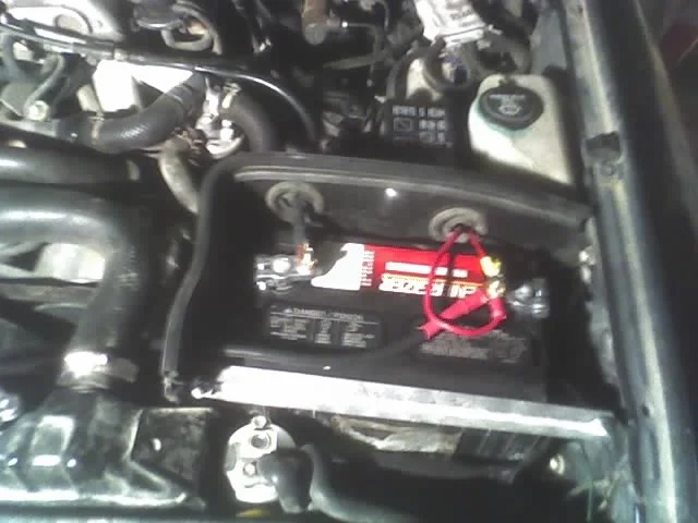

I think I know who you got that tray from. You live in Twin? I'm up here in Mountain Home if you want to see in person what I've done. Or, if you are going to the BLM Land use meeting with the ID state Off road Association & Blue Ribbon Coalition in Twin on the 14th, maybe I'll see you there. I wasn't planning on driving my truck but can if you need.

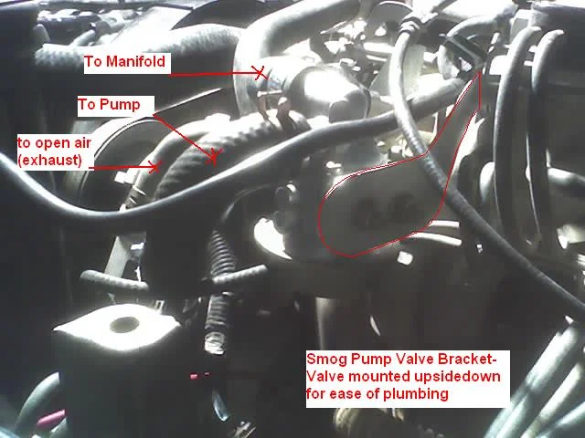

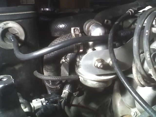

I got my Smog pump valve moved the other day. Had to turn it upside down so the hose fittings would point in the right direction. I used a piece of aluminum sheet I had laying around to make the bracket out of. The hoses alone held the valve up solid. I put the bracket on it just to take the load off the metal tube coming out from under the manifold.
more

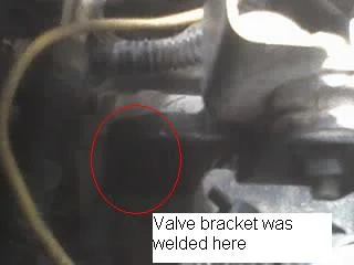

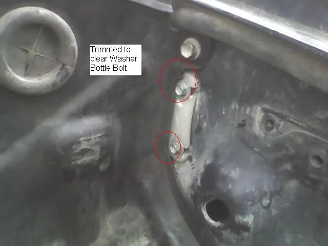

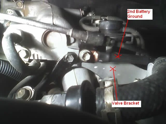

It was all pretty easy. Tearing the stuff out of the engine bay corner was straight forward and obvious (as was cutting the OEM smog pump valve bracket.) The hard part for me was trying to figure out where to put the Smog Pump valve. I was going to put it on the innerfender till a friend pointed out those 2 bolts. I used the OEM hoses by cutting three 90* bends off of them. The hose going to the pump is 2 pieces spliced together with a 1" piece of 3/4" ID copper tubing. I looked around for a new piece of 7/8 ID rubber hose but it's not a very popular size. Plumb the valve in first and make a bracket to hold it up. It was pretty solid with just the hose (I ran it that way a couple of days). I just didn't want to risk stressing anything.
All together I spent less the $60 on the tray project (I had an old battery laying around).

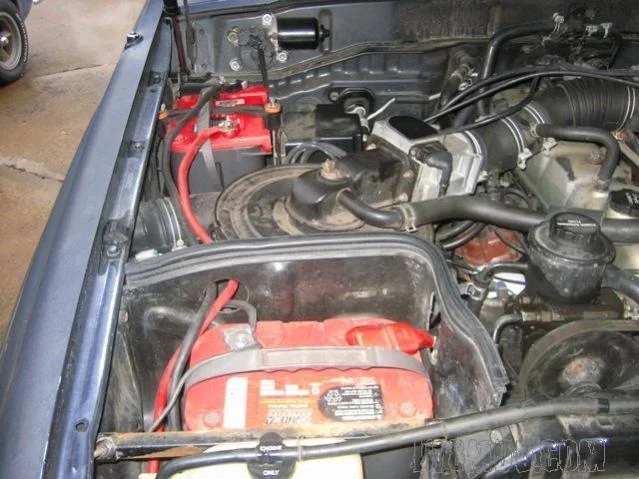

I just hooked the 2 batteries together and ran a second lead from the alternator to the second battery.

I made a battery tray with bracket to hold and relocate my Cruise Control actuator and Coil/Igniter. Works really well with the Optima battery because of the size.
