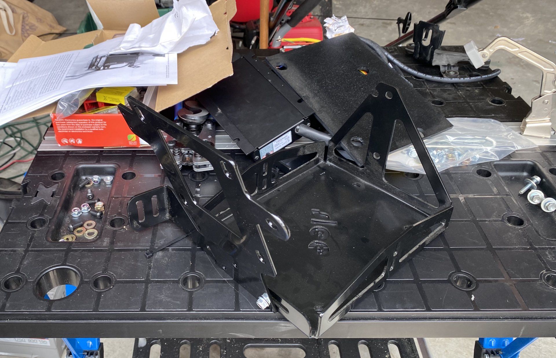

Maybe a question for Slee, but have you tried shoehorning a group 24 battery into the aux tray? I would like to put a group 24 battery and Redarc BCDC1225D in that position. Any pictures of how you mounted the Redarc to the Slee tray?

Definitely a @sleeoffroad question. I’ll follow up with better pics of the RedArc mounting bracket soon. Christo may offer feedback.

i put the same 1225D and a group 35 in my 2014 2 months back. Cristo has the mounting bracket available, just gotta ask about it when order. At that point, Slee didn’t have it on their site. On my 2014, the mounting bracket fits on the right side of the battery tray (looking into the engine). I think it’s due to the fitment with the HID module on the left side. Can you take a photo of the left side to see the fitment next to the headlamp on the model with LED headlight?
