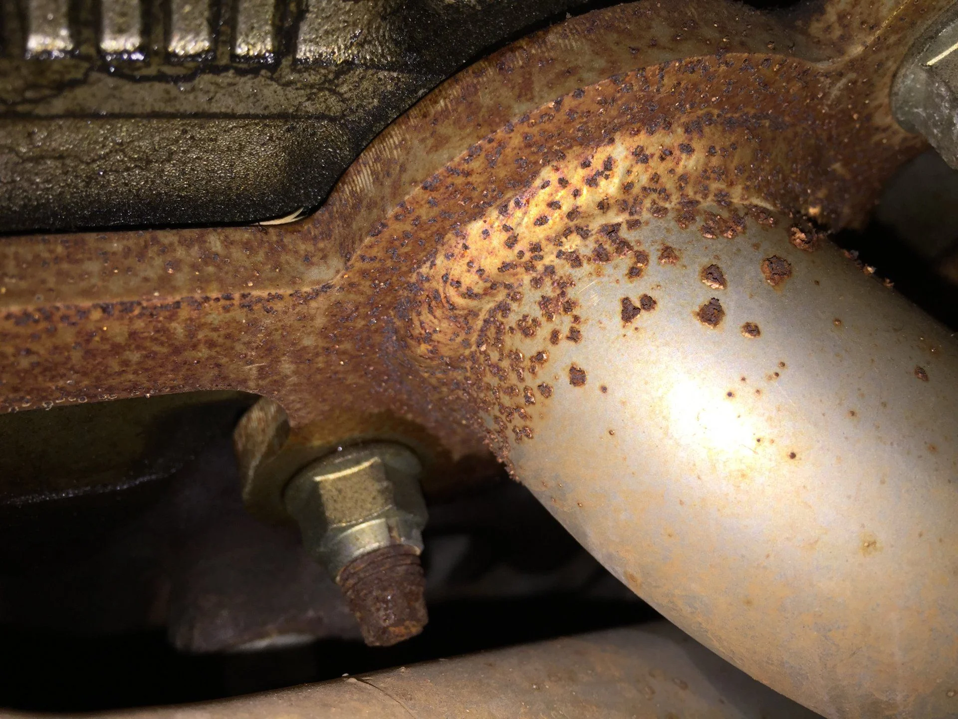

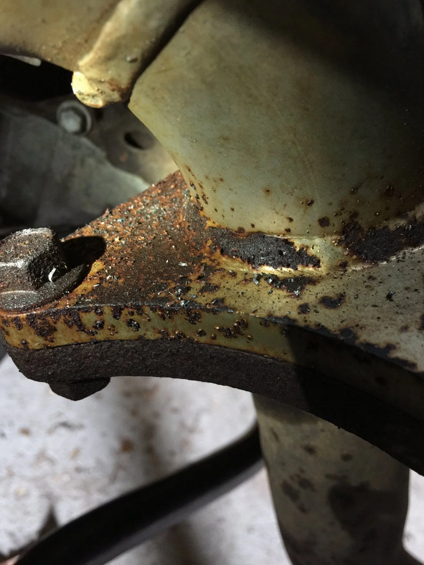

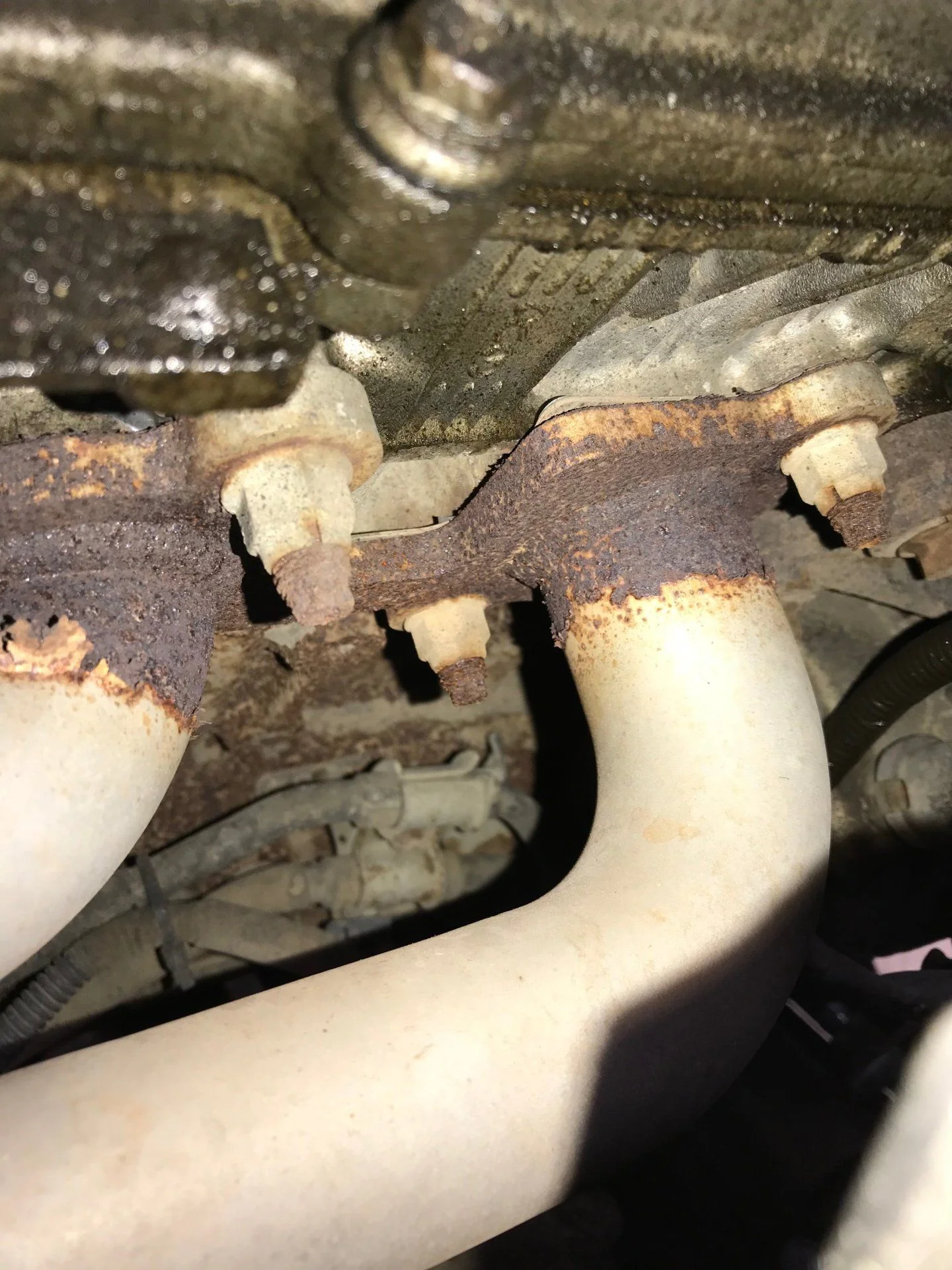

Mine are apparently the ones before they switched to stainless, they are heavily rusted.
I just sent them an email, hopefully they will treat me right.

That looks cosmetic and to be expected on coated mild steel IMO. The issue wasn't the mild steel vs stainless per se. There was at least one production run done before a design refresh to address some issues. Don't have the specifics on them or know if it was all mild steel units though.
If yours were from the GB on here in 2010 then they're probably from the affected lot. Post an update when you hear back. :beer:
