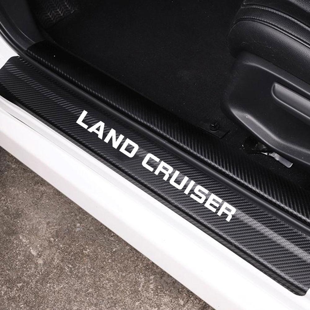

A Google search for "Land Cruiser door sill" returns exactly what I think of when I hear door sill:
No hate, but I didn't know what OP was talking about at first.
