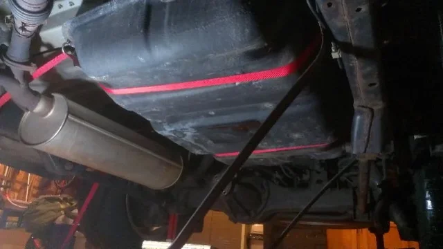

Straps are a good idea. On the left side the tank is tight against the frame, so I could go over the frame rail on that side with straps. On the other side I may have to fab some rings to hold the straps, possibly using the screws that hold the current straps up.

Now I ran ratchet webbing straps over the frame on one side, and through loops I screwed in using the bolts that were holding the steel straps up. Ideally the webbing straps aren't where the metal straps will hold up the tank, as that would make the webbing harder to pull out. Cross fingers and slowly remove floor jack.
Now set the cover on the floor jack
Raise it into place
Pull out the webbing straps, with a little wiggling of the cover. Put the steel straps back up, attach the parking brake cable, install the drive shaft (after lubricating), done.
