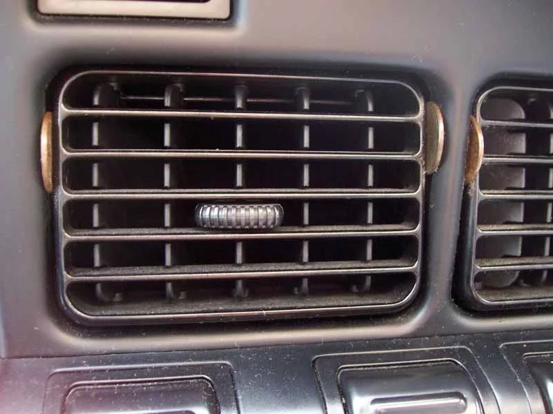

Now officially part of the club with a 1997 AE with 270k miles on the clock and getting right to work on resolving baseline items. I'll keep the questions in separate threads easier follow up.
Fist thing I noticed are the HVAC vents are supper loose and will droop. Is this something that needs to be resolved by full replacement of the vents or is there an alternative way to resolve it.
Get some velcro stickers and place the soft side of the velcro on either the top or bottom of the vent or housing. The goal is to create an interference fit while keeping the small velcro sticker out of sight. The sticker can be really small. Easy fix.
Way more elegant than jamming Velcro or foam or felt in there:
I use foamy ear plugs.
Not overly elegant, but super effective.
Elegant = new OEM part. Everything else is just hacks. Velcro is completely out of sight and adds damping/anti-rattle that a hard plastic part can't do. It's also not jammed in there. Maybe I just got lucky with what I had on hand but the vent action feels smooth like it should and the small velcro stickers are out of sight.

Been discussed: Search terms: loose floppy droopy drooping vents ---
Read post #9 in this thread, discusses using a couple of rubber O-rings over the pivot pins on the side of the diffuser/vent thingy:
Or a few other suggestions in this:
I couldn't deal with the droopy vents on a truck I bought. Replaced them all with new OEM.
Something just set me off driving down the road having the vents flopping all around but they also had more issues that the solvefunction fix wouldn't correct. (some were straight up broken).
They all are still available OEM (at least when I bought them about a year ago). This went along with another number of things I had to correct so in the overall scheme of things it was not huge in my particular situation. You have options.

Agreed...and if you are baselining, I personally take that as fixing any deficient issues to factory OEM correct...not jamming pennies or ear plugs in the dash board. The new vents are not that expensive and still available...to me, it was very satisfying to just replace them so they function like new again. And just to put it out there, I have several @Outsane products that I love, but the bushing correction piece wouldn't have fixed mine.
