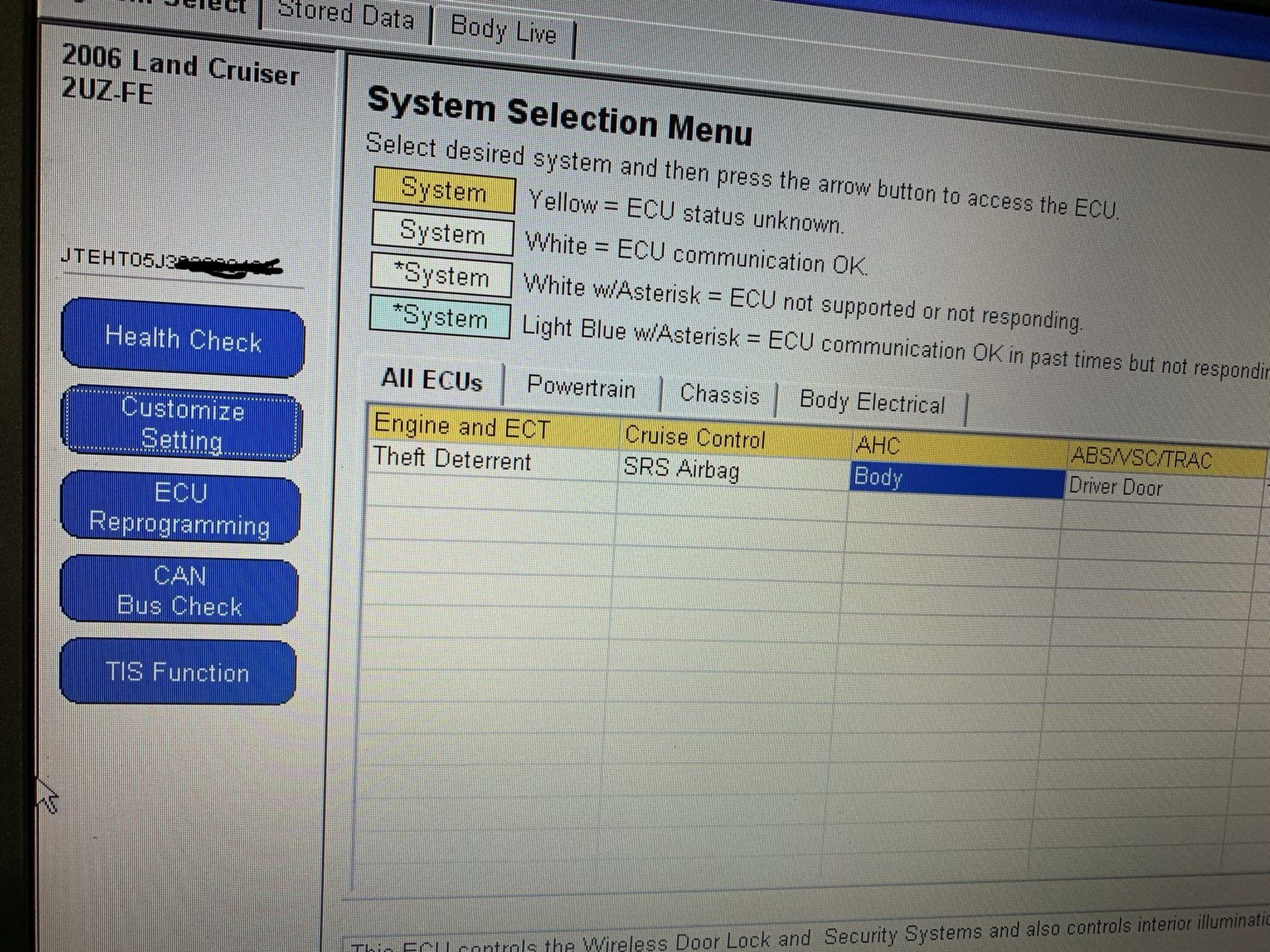

^^ was just about to post that. Don't understand why all the wire pulling/cutting when you can program them from techstream.
