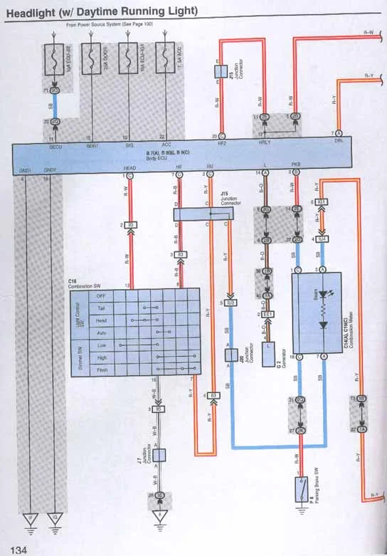

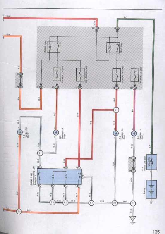

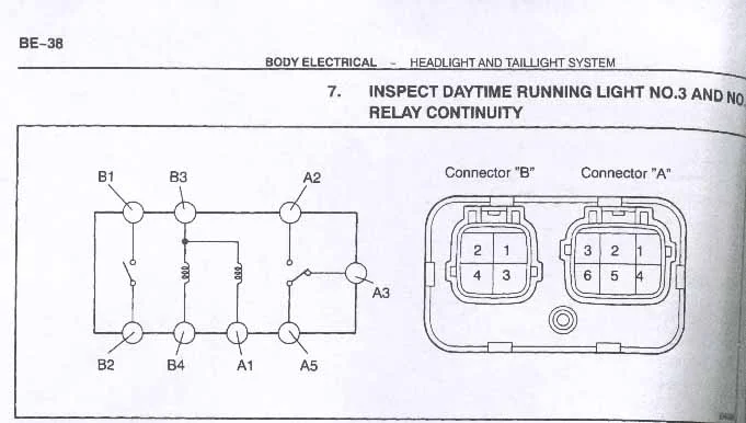

I took a look at the DRL schematics. There appear to be two plugs going into the DRL relay, one has 4 prongs, one has 6 (of which, I believe only 4 wires are being used). The 4-prong plug, call it connector "B," needs to be plugged in since w/o it, there's no way the relay can every close. The other plug, call it "A," supplies power to one of the high beam lights when the relay is closed (high beams "on"). So if plug A is unplugged and plug B is plugged in, you can trip the DRL relay, but there will be no power going to one of the high beams. OTOH, when the relay is in the normal "off" position, you should still see both DRL high's illuminate. The reason is when the DRL's are on, the highs are in series. There's a junction in between the two lamps. When you turn the highs on, there's a power signal from the low beams to trips the relay. There are also two high beam relays, one of which powers one high beam (or both when the DRL' s are on while the other powers nothing) while the second relay only powers the other high beam when the highs are on (in this case, the relay triggers and closes the path from the second high beam relay to the second high beam light, while the junction between the two high beam lights gets a new and different path to ground, allowing both high beam lights to illuminate at full intensity.
Anyways, that said, I think the only way to disable to the DRL while keeping the high beam function is to cut the path to ground for the DRL while not altering the path to ground for the high beams. The magic lead that I think will do the trick is pin 3A of plug "A." Which one is that? If you pull the relay out and orient it so the group of 4 pins (for plug B) are on the left while the 6 pins are on the right (for plug A), pin 3A is the left-most pin on the top row of the group of 6 pins (white w/ black stripe, but careful, as there are two of them for plug A). Better yet, wire this to a manual switch in the cab so you can enable/disable the DRL's manually.

Here's what I mean. When the DRL's are on, the power goes from the HEAD HI relay through the 20A HEAD LH-UPR fuse to headlight LH to headlight RH to pin 5A to 3A to ground. Power also goes from the 20A HEAD RH-UPR fuse to pin 2A, but that switch is an open circuit.
When you turn the high beams on, the low beam signal trips the DRL relays at 3B. Power goes from the 20A HEAD RH-UPR fuse to 2A , goes to 5A since that switch is closed, then goes to headlight RH to pin 1B to 2B (since switch is closed) to ground. Also, power goes from the 20A HEAD LH-UPR fuse to headlight LH, then to pin 1B to 2B to ground.
Notice that pin 3A closes the loop to ground only when the DRL's are on, but when the highs are on, pin 2B closes the loop to ground. This is why I think one should cut pin 3A if you want to disable the DRL's.

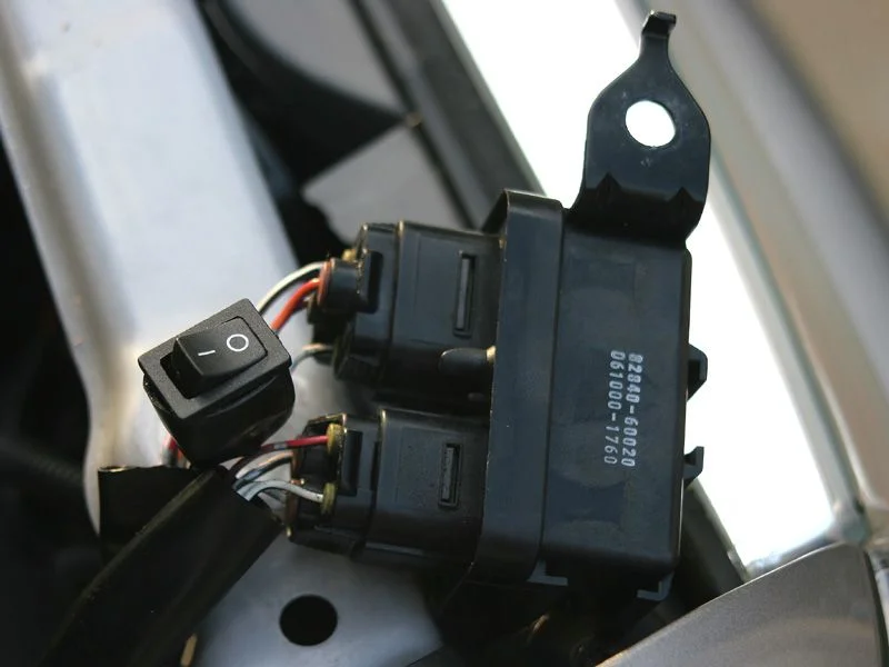

that's a good point (lows stay on while the highs are on) indeed ...unless you had a BI-xenon equiped headlights such as a range rover , i'll probably do the HID thing in the near future..... tonight i am wiring a switch for the wire that i have cut but i am leaving the switch next to the relay (for now)...

I finally gave in and went for the wires at the relay under the hood today. On my 06, it's a red wire w/blue stripe at A3. I didn't want to cut the wire, so I unplugged the relay and managed to get the red/blue wire plug out of the connector. Worked like a charm and can be plugged back in if anybody wants them in the future.
