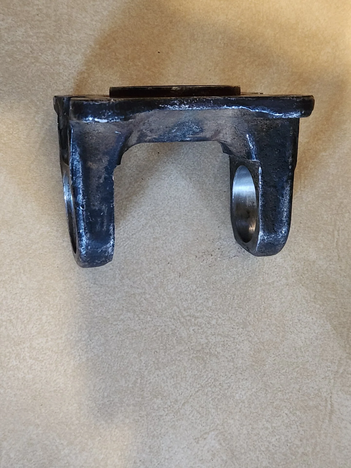

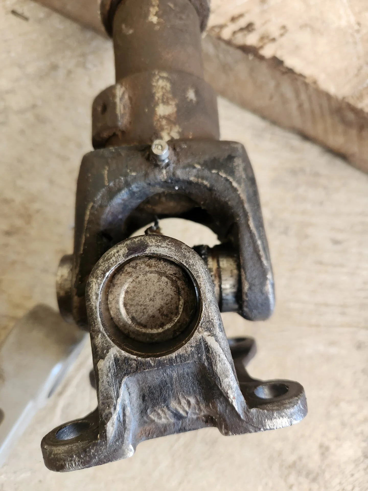

Hello everyone. I have been looking for the front driveshaft u joint for over 6 months with no luck. I live in Malawi and had help looking and could not come up with the right size. I price South Africa Toyota and it was going to be $1,500 USD for 2 u joints. I couldn't pay that amount. I returned to the States over Christmas hoping to find. Unfortunately Napa cannot find the correct ones. Any help would be appreciated.
Measurements
1.98 inches inside
1.10 inches cap size
1999 Toyota Landcruiser 100 series
VIN/chassis # JT111TJA008011280
MODEL. HDJ100R-GNPEZW
3N2LD40A03AA442F
Engine # 1HDC180114
Good on you for putting in the VIN and all....
U-joints 04371-60051
Should be $60-90/ea online in the States. Don't buy fake ones on Ebay nor Amazon. Or can buy from Partsouq but might take a couple weeks during the holidays.
