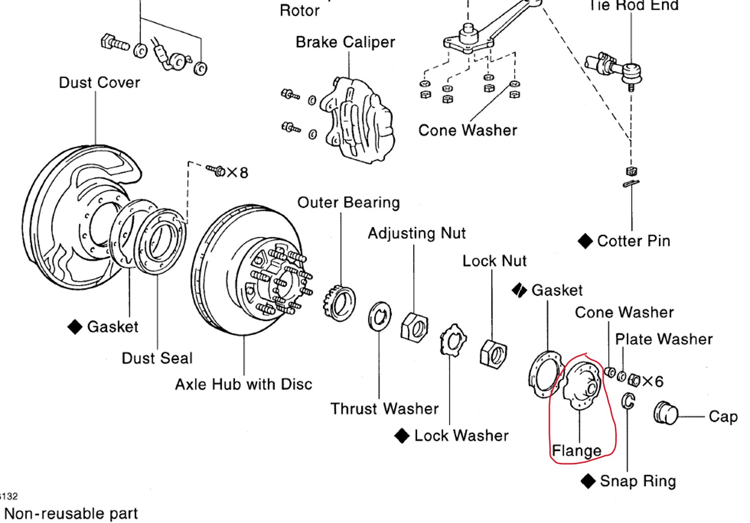

Inspect the condition of your front drive flanges as well. I removed a considerable amount of play in my front axle by replacing those.
To be sure: you mean this flange?

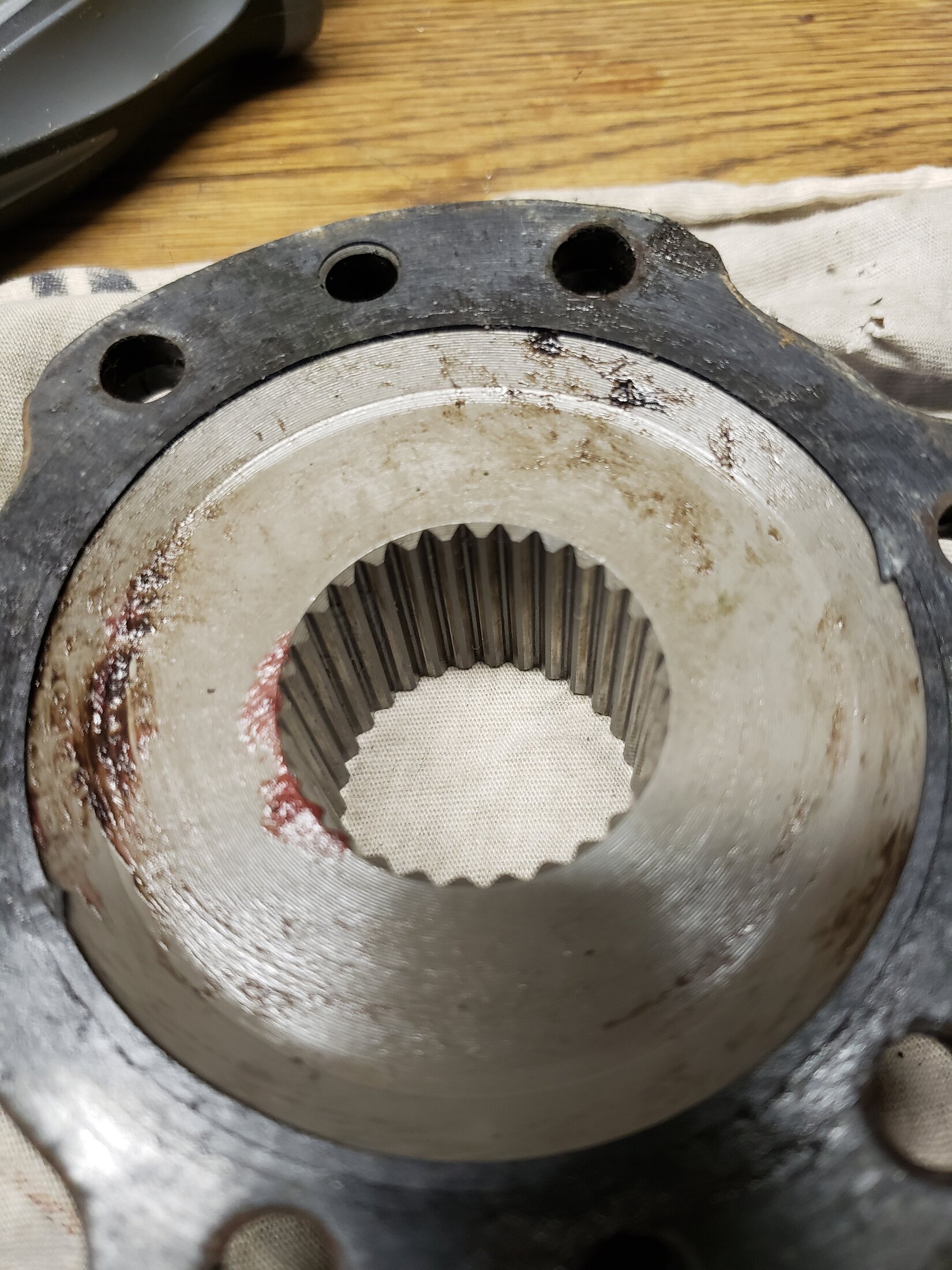

Post up some photos of the splines (drive flange and stub shaft) once you have things apart.
FWIW and future reference, you can brush Loctite LB 8012 Lubricant (65% Molybdenum Disulfide "Moly" paste) on splines (Drive Flange, CV joint stub shaft, slip yolk splines, axle shaft splines) along with wheel bearing grease to help protect them from wear. Another option is to use a NLGI #3 grease with Moly on splines. Either will help cushion the splines and prevent metal-to-metal contact.
This is the offending side. All looks good to me. Agree?
Also, the noise is gone with this removed... so it doesn't look bad to me, but it must be.
