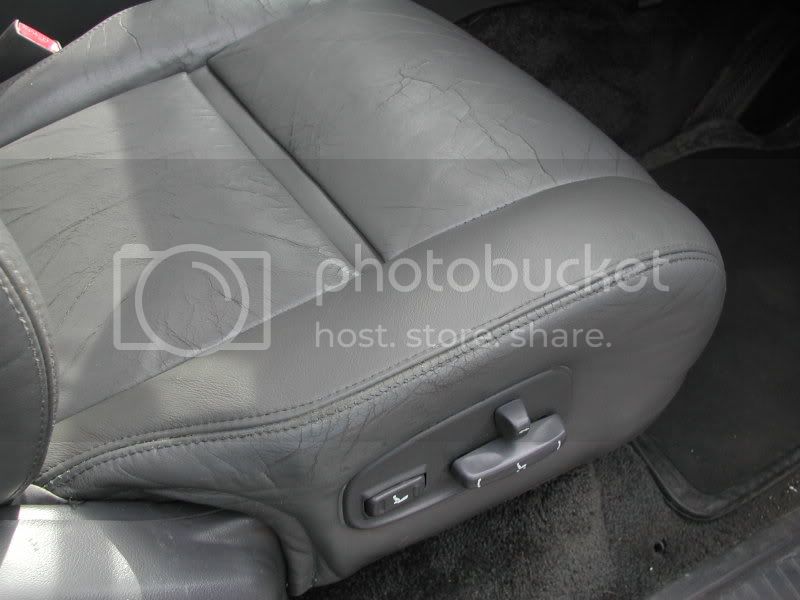

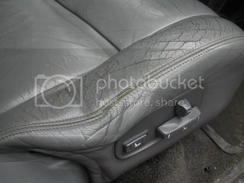

I beleive you need to remove the cover and those tools. What you will find once in there is that the metal frame on the outside of the foam has cut into or possibly through the foam. It's from sliding in and out. You should cover those areas with some burlap or other material to protect the new foam from doing the same thing. I plan to pull my cover and see if I can weld a small strip of metal on those rods to act as a shelf and forgo the foam replacement.

I planed an afternoon/evening deal, had a split seam in the cover to repair, was going to clean, do whatever was needed. That was foiled by a friend getting stuck about a 5hr drive away, so had to jam it back together. I didn't need silicone, the biggest pain was getting to some of the hog rings, some aren't in the easiest spots.
Was going to put metal over the switch wires, but the foam worked very well. It supports the upper foam well and adding metal would have made more hard edges to cut it.

I concur. I just wish I had added some extra support on the outer edge to keep the foam from slipping back inside the frame.
Please elaborate. I'm about to do this and if I could improve mine, I would love to.
Rebuilding the foam is an easy job. Even if I bought new i would have added some fabric to reinforce the area over the switches, without it the wires will cut into it again. This is what I did and has held up well;
