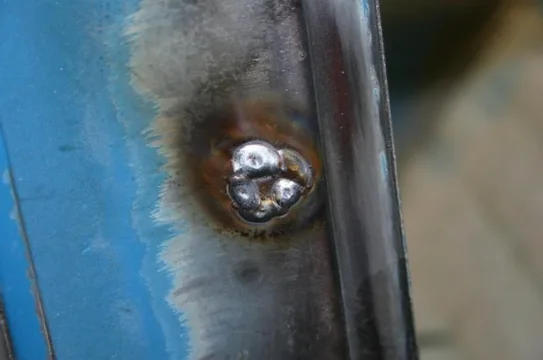

I fill holes like that by taking a scrap of steel with some snips and cutting it to fit roughly in the hole. Once that's done, I back it up with the copper and weld it in. I do this to minimize heat build up and warping.
With the plug welded in...
Minimal grinding and tada!!!
Takes a few minutes to cut out the plug. I don't normally cut it to be too tight of a fit, just so that it fits in the hole flush.

NICE!
I started cutting out some material, but wanted to see if there were other options!
Yours came out GREAT!
Nice job!
