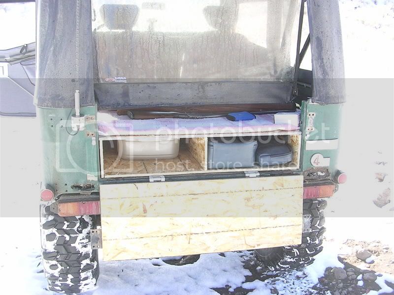

I haven't started this project for the 100 yet but I did prototype a set for the FJ40. I used scrap wood from a construction site just to get an idea of how to make it work.
I like the idea of plastic bins rather than drawers. Maybe just some 1X2 framed trays with 1/4 ply skins and plastic runners to keep weight down. Slides and heavy drawers seem to take up a lot of room and add weight.
I carpeted the top so Jake, the dog, would have better traction. The tie downs are standard hatch rings like those used in the access covers for the crawl space in your house. I really don't use them much because they are usually under gear or in the wrong place. I added a couple of pieces of unistrut later which works out much better. The 100 will get some kind of rail system for tie downs.
I learned a lot from this project.
A rail tie down system would be really cool. Anyone know where to source parts for something like this?
In my Fj40 I used Unistrut, it is available at home stores in the electrical department.
It comes in 10' lengths, if you know somebody in construction you could probably get short pieces free.
They sell all kinds of straps and stuff that work with the system
You could use an eye bolt with these nuts to fab an adjustable system
I know it's not as pretty as some would like but it is very versatile.
